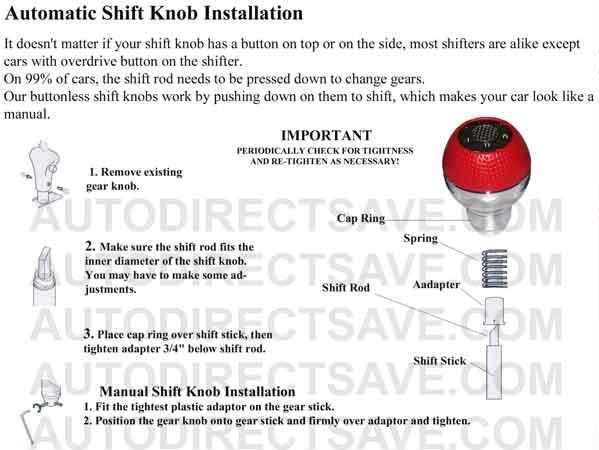

I found this pic online. i haven't tried this yet thou
