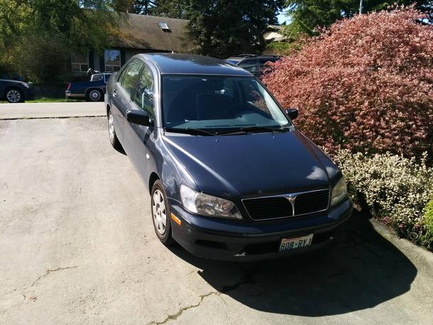

Here are some current pics of the car:
This is the biggest body damage: https://i.imgur.com/kaOuX1h.jpg located between driver side doors.
If everything goes well with the mods, I will also look to add a CF Evo 8 spoiler and a CF hood/trunk. Maybe some interior, but that is way more far down the line, I think given my experience the list above will keep me busy for a bit.
