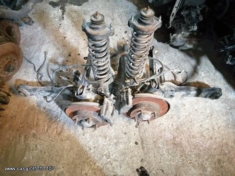

Hello i know about 89mirageman rear kit but i found on my local junkyard a complete rear set for 80 euros. Has anyone done this? I have a 99 lancer converted inside and outside to EVO4. Planning to make it an evo but until then i can't stand the rear drums . This are from a lancer cg euro spec 4x100 patern
lancer 02-07 rear arms

i am answering since i did it yes they are same you can fit cg lancer rear hubs to a ck. It's plug and play. No more rear drums. Europe version is 4x100 with disc brakes on the rear
