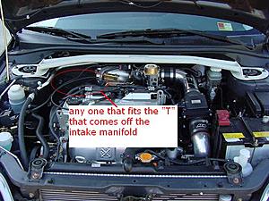

not sure which vacuum hose to splice under the hood. anyone drop a picture on here quick??? Thanks!!!!

I think you can just splice any vac hose, so long as it's close to the point you're running through the firewall. Your best bet, call RRM and ask. You'll get no better answer than to go to the source.

god damnit someone send me a picture of which vacuum line to splice. =)
(as per step 13)

ahhh thanks bro you saved my life haha

that picture didnt do me any good, anyone have any pictures of EXACTLY Where to splice that **** and what the FUEL REGULATOR IS? NEED PICS

Splice it on the vacuum line that goes from the manifold to the fuel regulator. The fuel regulator is the brass diaphram looking deal on the end of the fuel rail where the injectors are. It's a single hose that goes from the top to the manifold. You will find it easy with this discription. It is only about 6 inches long.

yeah I just got this pic from RRM, i think it shoulda beeen included with the install pics, cuz i severed the wrong vacuum hose yesterday
but thanks for the help anyways y'al!
