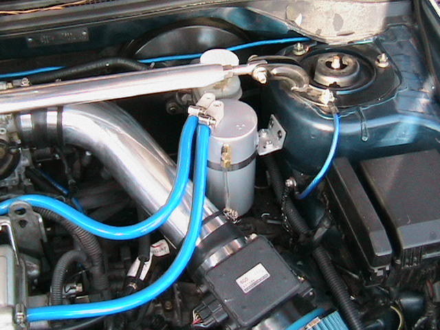

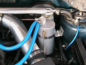

Just recently I installed an Oil Catck-Can. I love it and I was prowd of my install. When I took it for a ride, my oil pressure was 100psi when wide-open.
the problem is as follows...

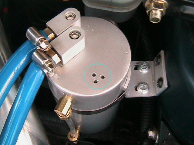

the catch-can made a air-tight seal which cause the high pressure. to solve this, simply drill a few holes in the TOP to release pressure.
the intall involve:
1. mounting the can, use self-tapping screws.

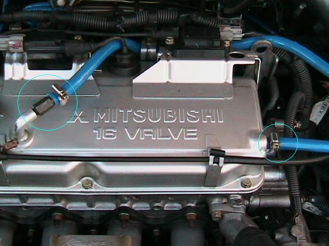

2. run the (2) hoses from you valve cover (one on top, one on driver side) to the two outlets on the can.

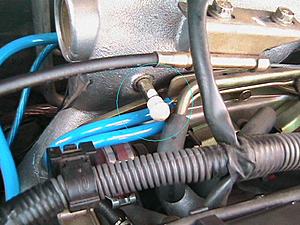

3. the two place that the hoses were connected to (one is on the black intake tube right at the trottle body (cold air kits don't have them),and the other is on the front of the intake manifold) need to be sealed with vacuum caps.
4. drill a couple holes in the top to releave pressure.
I now many will think this is simple task, but maybe this will help others( like me ) who's blood is lower in octane...

You were not supposed to mount your catch can like that thats why your pressure went through the roof. One side was for the side of the head and the other for the return to the intake tube.
Though you did a good job by venting the can and keeping the pressure down. You have now immitated the arc style can minus the retun hose to the intake again (or to the ground like they describe in their directions)...
No need for a vent hose now.
Your PCV is VTA. LOL
