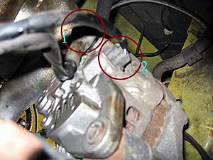

So im trying to upgrade the big three on my 02 OZ rally. Im getting stumped here because everywhere I read it says to upgrade alternator to engine ground, battery to chasis ground, and alternator power to battery. I cant find out what any of the 2 existing wires do. Can someone please tell me what exhibits 1 and 2 are.
I stole the O.P.s picture for reference.
