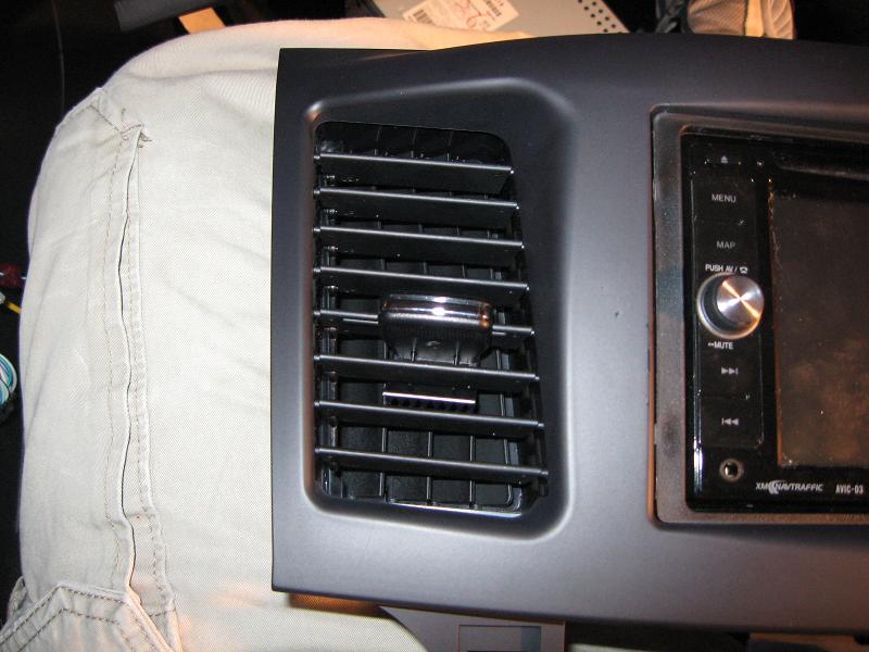

Got my dam dash kit!!! I plan to install this tonite. So far looks like it will match pretty good. Maybe a hair darker. Unfortunately for us avic d3, etc. owners, looks like the HU will be tilted back a little.
I will post pics tonite or tomorrow morning if i am able to get to it. Installer.com delivered, but make sure you allow 7-10 buisiness days for delivery.

GOt it in. Here are some pics. It fit almost good. It sticks out at the bottom a bit. The vents fit good. Match is almost perfect, and install i would rate at about a 3 for difficulty from 1-10, 10 being the hardest.
For the avic d3 owners and HU's alike, it kinda sucks because the HU tilts back. A flip out would do better for this ride/kit. Maybe one day schoshe or something will come out with one that doesnt.
The hardest part about this was routing the sirius antenna wire around the window, and through the plastic piece next to the passenger door. Not to bad though. I took a bunch more pics, but could only upload 5.
Hope this helps someone.

Nice, it looks quality to me. Much better than the stock stereo, huh

It looks like there is a slight gap at the bottom, is it the same on the other side? Did you have the fosgate system? If so, how was the wiring done?

Yea, it sticks out a small bit on both sides on the bottom, and not because of space for the wires. It has more space behind the radio than any other car ive seen.
I had the plain jane stereo, not fosgate.
THe kit is still settling in the dash, meaning every now and then when i hit a bump, it creaks a little, but im sure it will settle. Fit was nice except for that small gap at the bottom. Im going to try to fix it later. I think the bottom snap in pegs are a little higher than the holes they go in.
The wiring should be about the same. The harness i used was a 99-7011, and no antenna adapter was needed. The basic harness has your power, ground, illum., dimmer, amp cut on, yellow memory wire, and your 8 speaker wires. Simple as it gets. The fosgate system may or may not have the speaker wires there leading to the factory amp. It takes about 4 minutes to pull the radio, and the post in the how to section shows exactly how to remove the stock radio. If you have the fosgate system, i would pull it just to see. There is two harnesses connected to the radio, but one is for the steering wheel controls. I didnt use this because of no interface yet. There should be about 12 or so wires in the bigger of the two harnesses for that metra 99-7011 to work.
