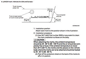

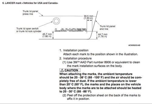

LANCER emblem placement?
Can anyone post/email/pm me the pdf from the repair manual for the placement of the "LANCER" emblem? It should be listed under the "EXTERIOR" section under "MARK".
Or can someone post the dimensions of the LANCER emblem location relative to the bottom/ right side of the trunk?
thx

heres the info ur looking for let me know if u need any other ones

Thanks, that is perfect.
