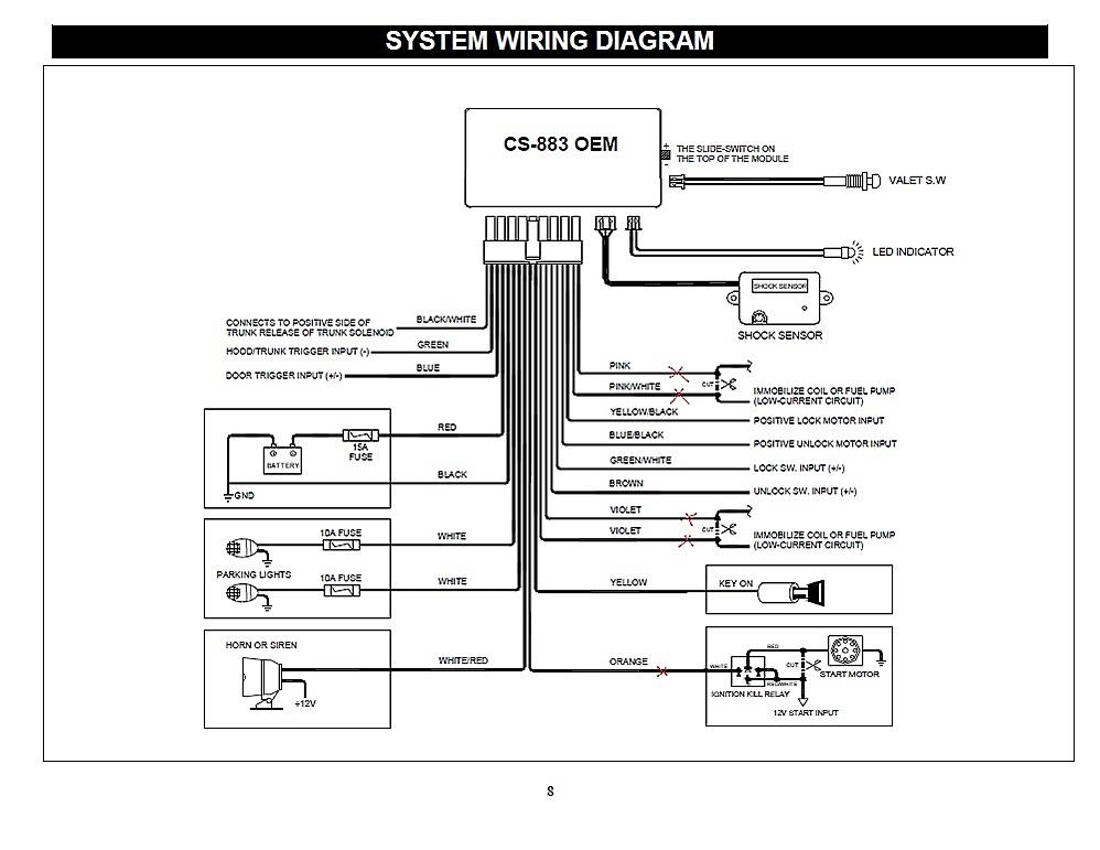

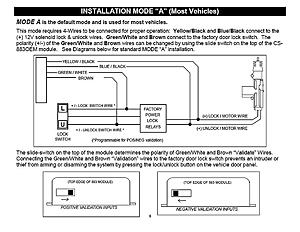

i have a 2008 lancer GT its the same as the GTS but with a 2.0L engine
the problem is that it doesn't have an alarm system and because it has a keyless entry and ignition system i didn't want to install an alarm system with a remote so i bought a system called crimestopper CS-883 ( http://www.crimestopper.com/2009/keylessentry/cs-883.oem.html ) it's an upgrade for factory keyless entry systems
i need your help for installing it
i've included some photos of the installation manual and highlighted the wires that i couldn't find (it's almost all the wires), i don't want to install the engine immobilizer
i know that the wires in my car might be different in color but if you can tell me how to find them and where
thanx
Attached Thumbnails please help me-untitled1.jpg   please help me-untitled2.jpg   please help me-untitled3.jpg   please help me-untitled4.jpg   please help me-untitled5.jpg

today i removed the door panel but i couldn't find the lock/unlock switch wires (validation wires)
any idea where can i find them
thanks
