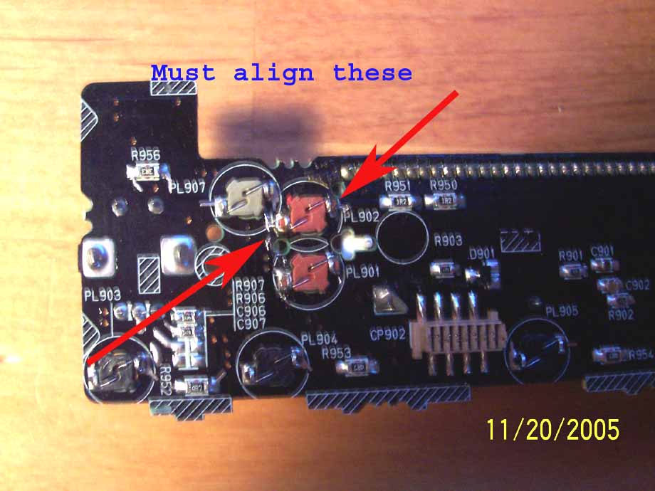

Now for the reinstallation of the LED.
- Make absolutely sure that the paint is dry before attempting to reinstall the LED.
- Carefully replace the LED holder making sure that the metal contact points are aligned properly. (see picture below).
- Now instead of pulling the LED holder away from the board while heating the contact points, you want to push the holder towards the board and heat the points.
- The sameway as before, one side at a time, little by little.
- A little soldier may need to be applied in order to ensure a good contact between the LED and the board.
And you're done. put your radio back together and it should light up like the picture below.
