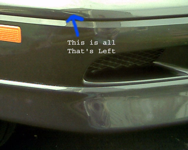

There is a little spot where it actually removed the paint, but for the most part the white lines are smooth like it was waxed, no cuts or scrapes just these damn white lines, so I don't think touch up paint is the way to go other then the one nick. Gonna try buffing when the weather gets nice
Old Apr 11, 2003 | 03:22 PM
DjDoubt's Avatar
Posts: 139
From: Fredericksburg, Va
Fixed here are pics of the bumper now, turns out only one scratch and the rest was just paint. I used Meguiar's Gold Class Wax. Just rubbed real hard with a terry cloth. Most came off.
Thanks

Old Apr 11, 2003 | 03:24 PM

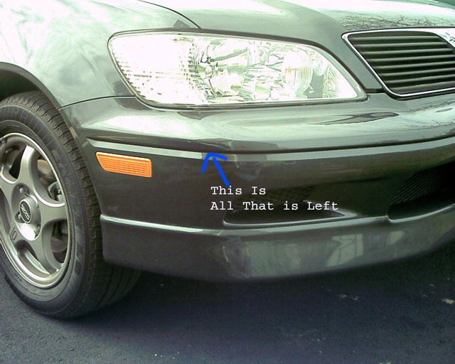

Here is another pic

Old Apr 11, 2003 | 03:37 PM
