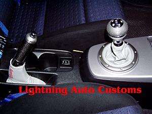

okay so i'm starting a little project for the shift boot, i hat the way the leather and the different fabric ones look so im going to fab up a plate like the ferrari's have and im looking for any help on this that can be offered im thinkining if i trace my shift pattern in card board i can then change to sheet metal, and cover it with vinyl or carbon fiber vinyl, black, or whatever.
any tips or suggestions greatly appreciated, included some pics to help get the idea.

i would leave the cardboard templet on there for a few days just to make sure you are giving yourself all the clearance you need.

Uh....the clearances and tolerances on the Ferrari shifter are considerably tighter than on a lancer and they require a rather specific shifting style. I wouldn't recommend doing this unless you make the cover/pattern out of a thin enough metal that it can bend if necessary.

theres alot more play in our cars than Ferrari's have... Their shift is stiff and direct, its pretty hard to miss gears, it just slides right in perfect so they can get away with the plate... If you do decied to do it i would make the gapping as large as possible or maybe just make a shorter boot like how bmw makes their auto boots. there maybe 2 inchs of leather versus 10-12...

Another thing you must consider is how wide our shifter is compared to the thin ferrari shifter

yeah that wide thing is a problem, i've got a short shifter too and looks like there's not gonna be too much metal if i cut it and make allowance for shift pattern, stand by i will updated with pics when i figure out my alternative, maybe shorten my stock boot to a flat piece. im p!ssed, this is frustrating. . . . . any helpful suggestions?
