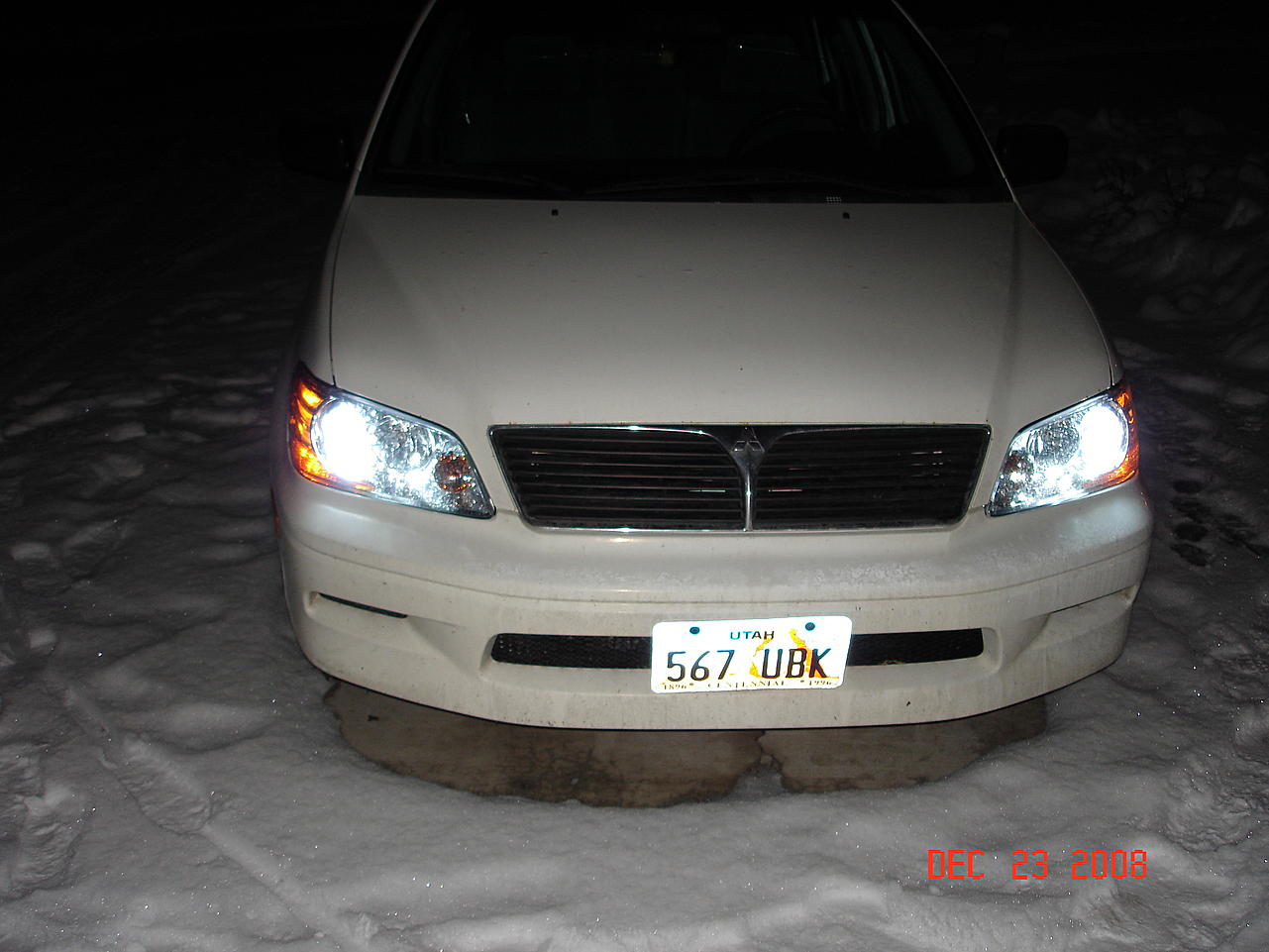

Lancer projectors +HIDs!
Here is my car with the chrome projectors on with 8k HIDs!Lancer projectors +HIDs!-dsc02771.jpg

Looks Awesome Man! Have you seen the new black ones that are listed up on like ebay and stuff? same thing as you got but lack housing. I want them so bad!
How hard was the hid install with the projectors? and modification needed?

it took only half an hour to install the headlights and hids the only modification you have to do if you want hids is to slice a hole in the big rubber cap that goes behind the projector to get the hid connectors through then seal the hole up with rtv or something like that. it was all really plug and play, no bumper removal needed, just three bolts on each headlight you have to take off and wiggle the headlight out of there.

Looks good.

nice heads.... nice to see someone get those ones installed... very nice

looks clean. gj
any pics of the cutoff?

ill try to get pics of the cutoff it is snowing right now and I think the cutoff is decent enough, haven't had any other drivers bright me yet.
