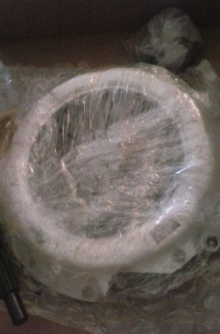

4g69 tranny went,lost 4th gear and i had a spare 4g94 trans so i swapped the gears (gives me shorter 4th and 5th gears now) first time I put the transmission on and started the car it ran awesome! the only problem was i heard a really loud banging sound...thought it was something wrong inside the trans so i pulled it all out and apart again, reassembled and put it back on..same noise. I then noticed the oil pan was pushed in a little bit s i took it off and noticed metal inside was being hit by the rod bolts.. changed the pan and fixed the problem..also changed the throw out bearing, pressure plate, clutch disc all with clutchmaster FX parts..car wont go into gear so its now sitting at the shop
