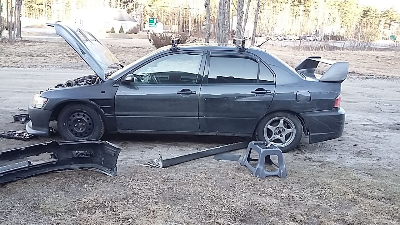

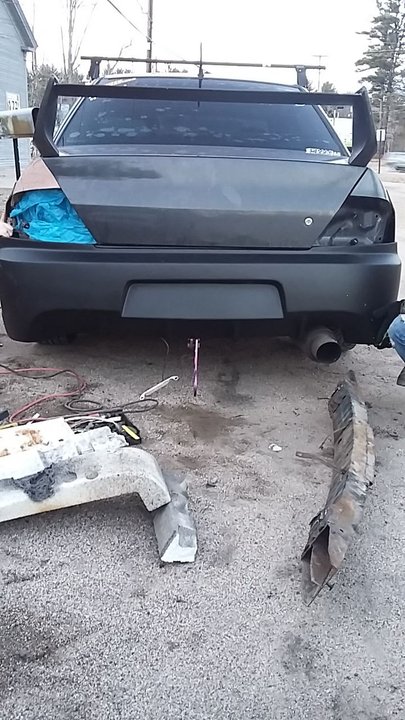

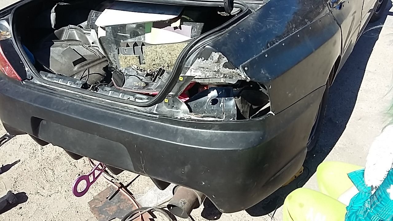

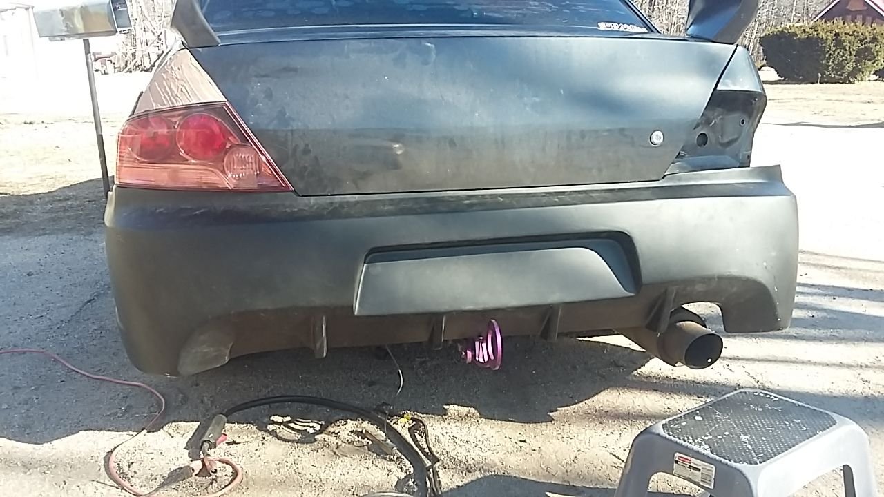

the evo 9 jdm rear and evo 9 front bumpers came in
c-speed 25mm wide fenders came in with the bumpers
Jdm 9 rear getting mounted and aligned

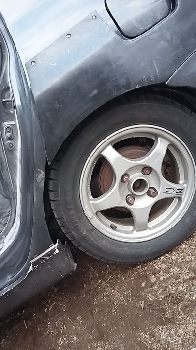

was trying to see how 17 would look...gonna go with 18x8.5 or 18x9

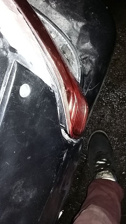

started right hand side tail
taillight box being fabbed up

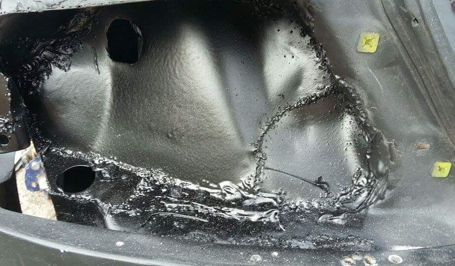

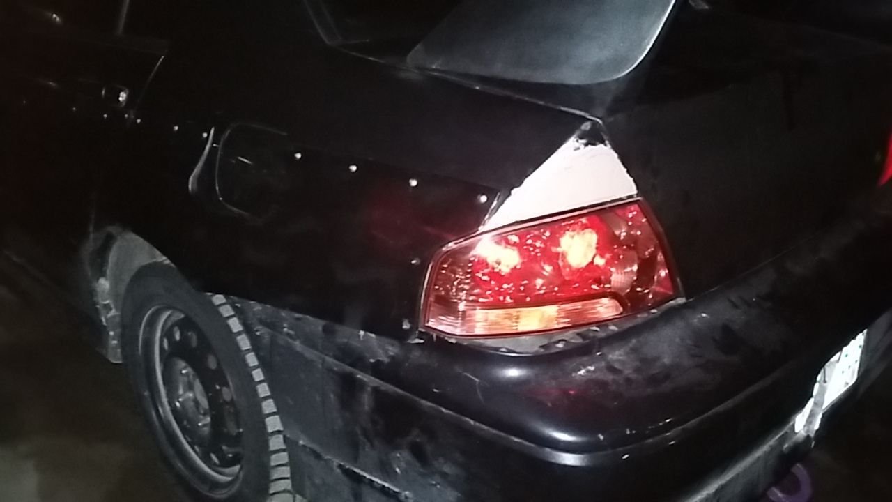

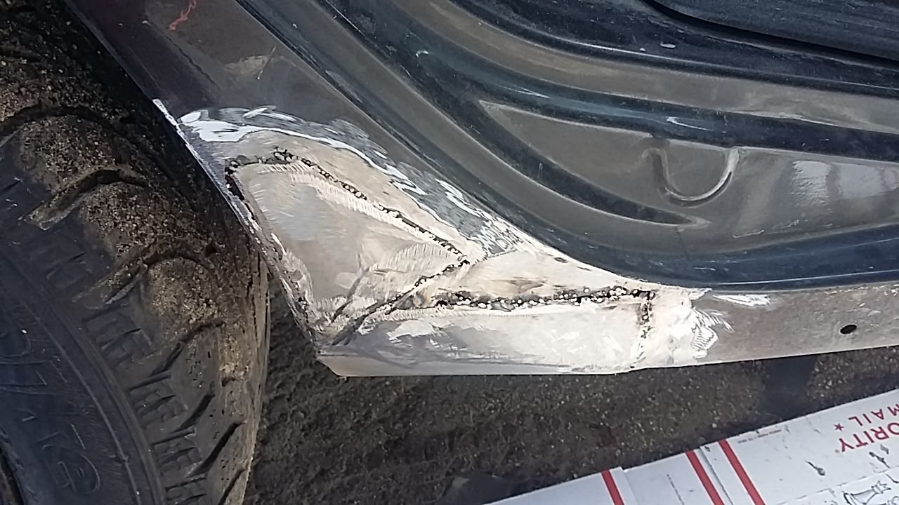

a little bit of rust fixing was done in the process
fixed the other quarter panel and cut out the well to fit wide *** tires!
smoother out and primed after cutting wells

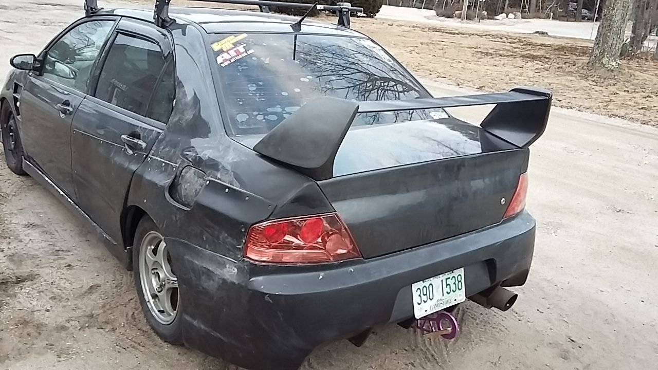

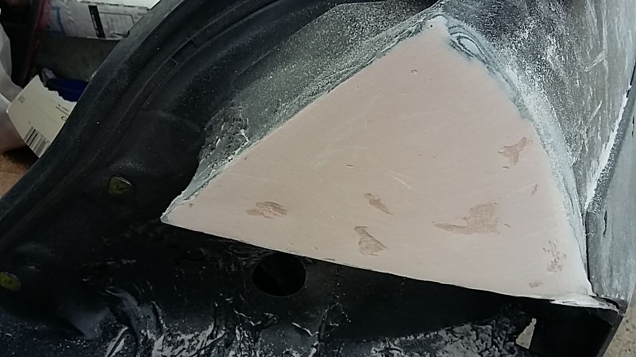

started the filler process and sanding
primed for now, gotta wait to finish underneath the wide fenders before i start moulding them on and then ill finish these parts above the light
both sides sanded and primed
boxes have been filled, primed, and rubber coated for protection

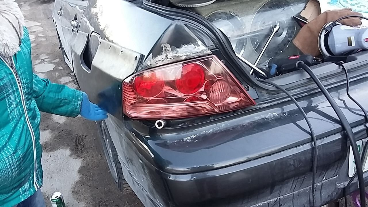

still gotta finish gas door area, not sure where to start yet

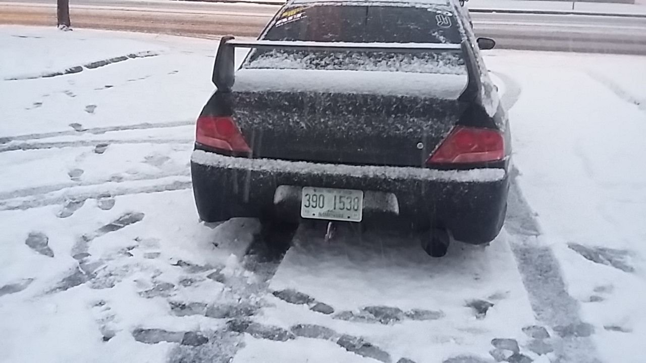

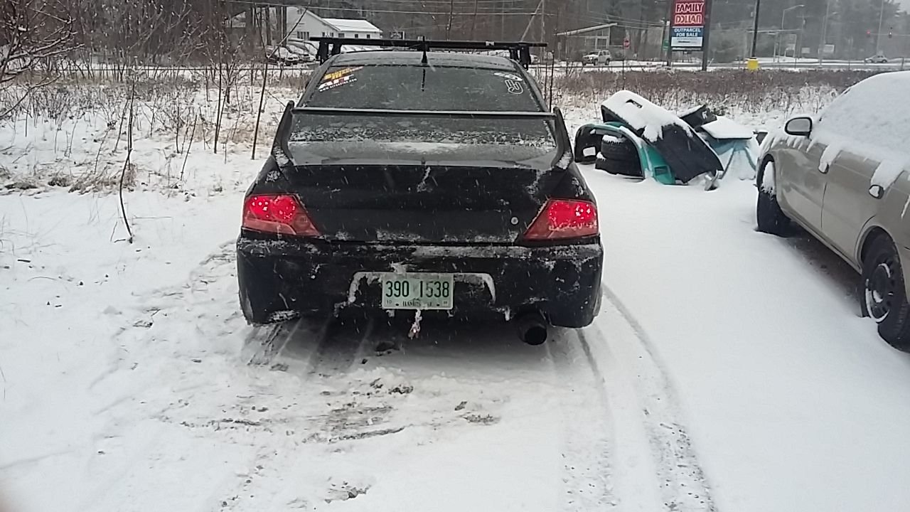

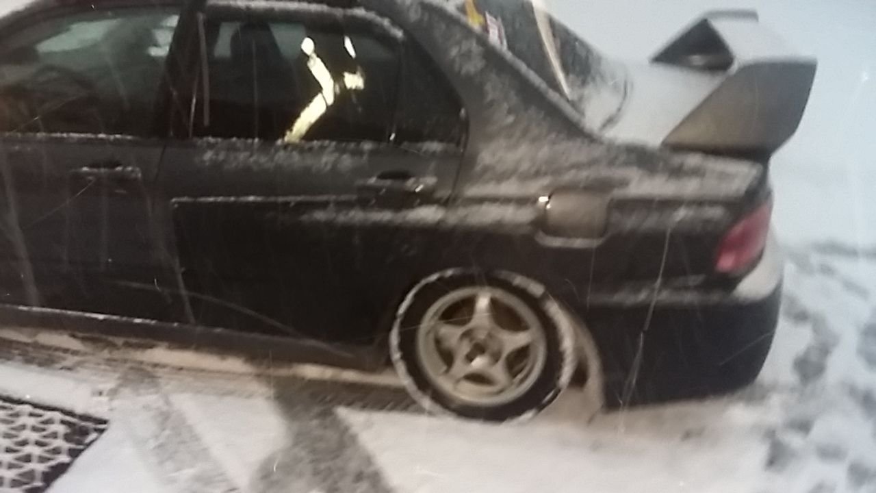

couple of snow pics

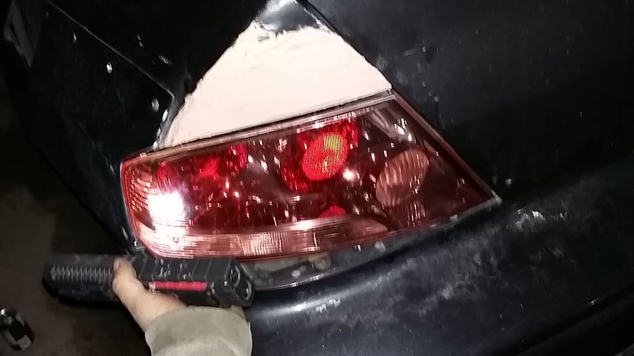

lights are in and working proper

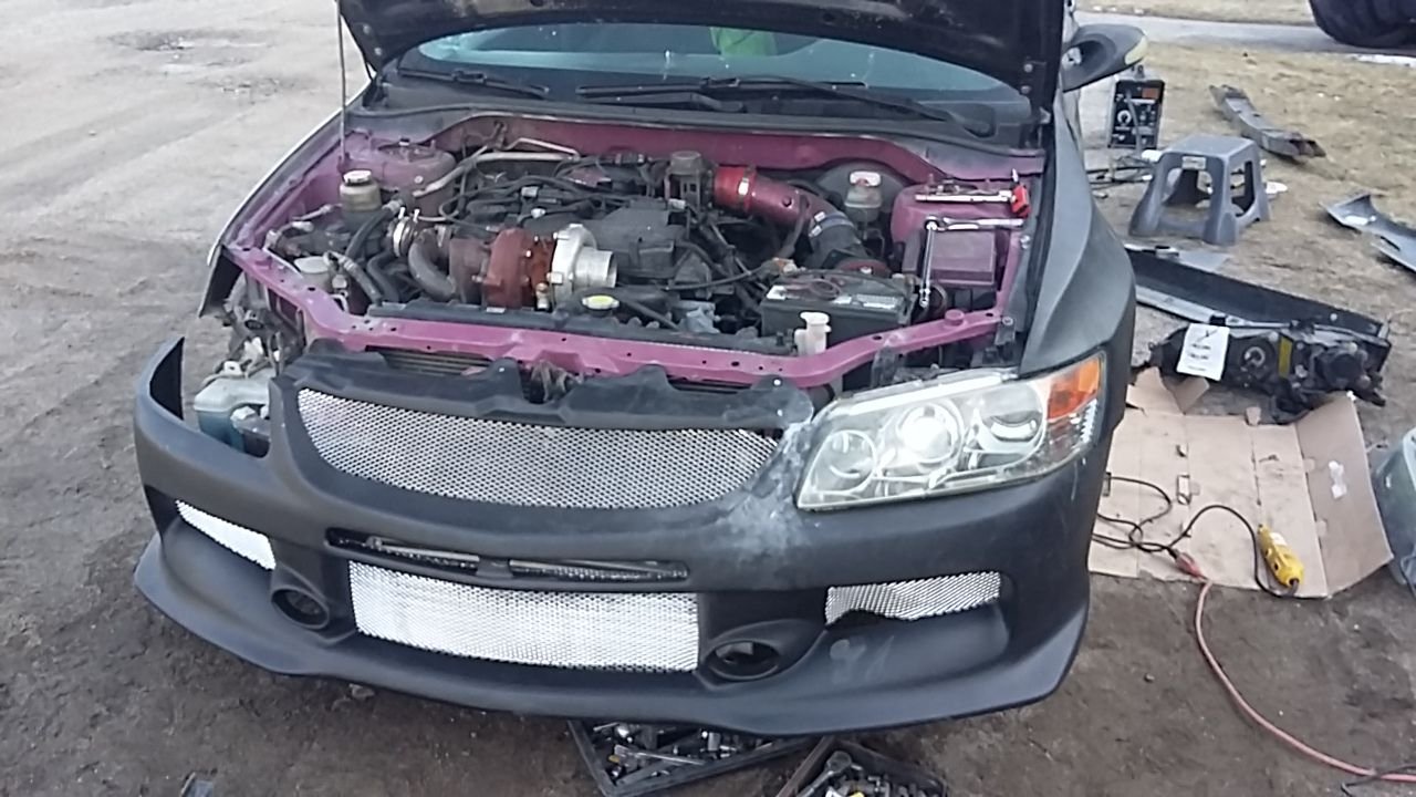

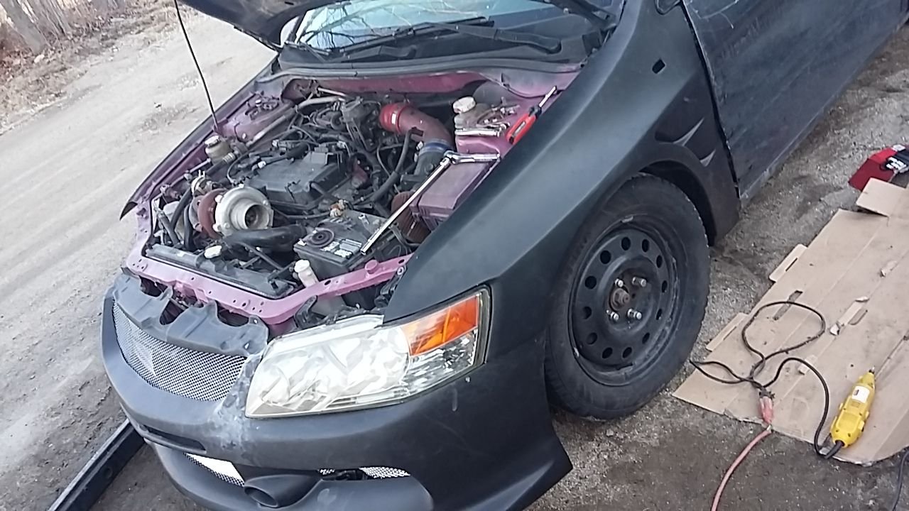

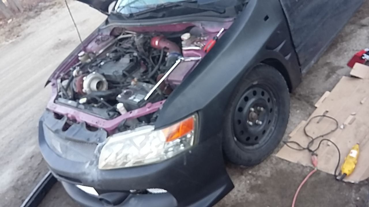

started applying the front panels and lights to get the holes preset for whn the hood gets here wednesday! Got a C-1 carbon hood from carbon creations on its way
not sure how to start the wiring on these bad boys... im using hids for the middle light and fog lights ill use a 3000k light but might need help wiring the oem ballast..
fixed the gap by the door and rear fender...bothered me alot im sure someone noticed it before lol

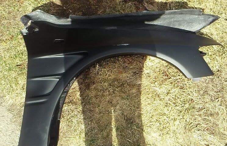

fenders up front are pretty wide gonna need some big wheels to fill these gaps
gas door still needs to be done..not sure how
