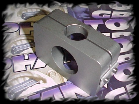

Here is PHANTOM GRIP!
ROAD/RACE
http://www.roadracemotorsports.com/

hmm wonder which one looks more for the money, you know Rock probably does show favorites but he also provides us all with vcaluable info iam sure that if the phantom solution was so great he would tell us so. granted he his also a buisness man but he's also a member. so if you dont wanna believe get the phantom try it out and if your spiders break you know he was right

I get loopy sometimes too. Honestly, I guess I was emphasizing more the fact that you shouldn't waste your money on that. As for hyping up ours... Not many of you guys will buy it. It is mostly a hardcore kind of mod. Serious guys that go to the strip will buy it anyway. Point being, not trying to sell our LSD in the first post, just making sure you don't waste oyur hard earned money on phantom thingy. If you are going to go through the trouble of pulling trans and dismantling it make sure it is for something of proven design.

Anyway, the BMtranny unit I have is virtually identical to the Phantom Grip unit. Yes the design will cause undo wear on the differential components but I have yet to hear of any mirage (I can't say lancer cause I don't pay enough attention to this forum) having a problem with spider gears. I have heard of 3300lb AWD 300+hp eclipses and more powerful/heavier 3000GTs having spider gears becoming damaged...but there are very few people with the resources to produce that kind of power from the little 4G9X series engines. If you have that type of money then you could probably afford to get a "real" LSD anyways.
Now for those looking into the Phantom grip or BMtranny units. You have to ask yourself if you will be doing the labor yourself (if not get the more expensive "real" LSDs) otherwise you won't save too much money as labor on a tranny tear down is probably around $500 or so. Now what have I noticed? Well I can leave two sets of tracks instead of one, I don't get understeer so bad going through a turn that I fly right off the course, I get to drive in STX class (not fun if you don't have all the other suspension already...you'll be in the bottom of your class), I can lay down the power through a turn now, I'm able to "shoot" into a main road from an intersection without sitting in place (still spin the tires but I get in much quicker).
Is there a lot of pressure on the diff case area of the tranny? Sure! Was there before hand? Yup I had stress fractures all across my tranny around the diff casing BEFORE I put the LSD conversion in.
If you have the cash and want a good LSD get a MECHANICAL unit! Clutch type units have several negatives associated with them that more than make up for the $200-300 you save over a mechanical LSD. Clutch chatter at low speeds/sharp turns with aggressive clutch packs, avoid the aggressive tuning and there isn't enough grip, clutch packs usually wear out after 30,000 miles so in 30,000miles the clutch type ends up costing the same as a mechanical unit. One thing nice about clutch pack types is that you can "re-tune" the LSD easier by changing the clutch packs of course all of this requires opening the tranny back up.
