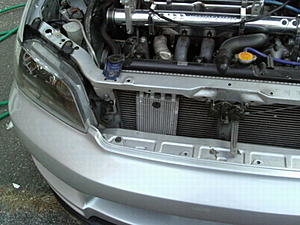

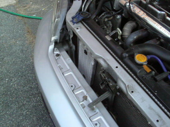

hey, real sorry i have been busy and i haven't been on the boards. ok i took some pics just now and i'm goin to post em as soon as i get home from work. srry once again

here are the pics
Attached Thumbnails Automatic Transmission Cooler-dscf0547.jpg   Automatic Transmission Cooler-dscf0548.jpg

Wow next... that is a little cooler for 75 bucks?? Did it come with everything for hook up?
You can get one twice that size from Kragen/autozone with hose and mounting kit for about 60-65bucks. PM Guru_Del as i'm sure he's still got the number for it. I personnally think bigger is better for tranny coolers. In the end i added about 1/4 of a quart more trans fluid after install but it worked great.
