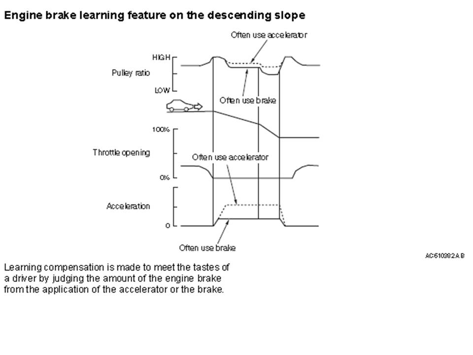

Two different drivers with different driving styles definately impact how the car drives. I found a document from mitsubishi about 2 months ago and it basically describes how the CVT and computer readjust for based on driver accelerator and brake inputs. See the diagram below for some details:
Based on your acceleration and braking input the ecu and tcm control the pulley ratio. I cannot post this doc b/c it is too big (38 pages total), but I did finally find the site where i got it from. Here is the link:
www.lancerx.ru/tech/lx_cvt.pdf
The figure I have attached is on page 27. The next section talks about "lift foot" and how the ecu compensates for that (I have found since I have quit lifting my foot off the accelerator except to hit the brakes the car responds much better). There is some good info in the doc. Some of it lacks in detail but you will definately learn how complicated the cvt really is, and you will get some valuable info from it.
