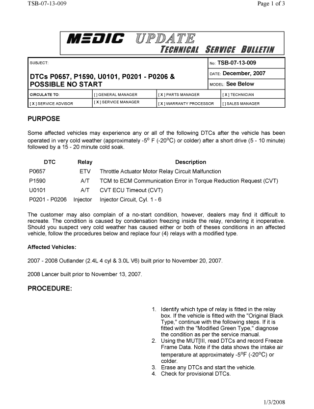

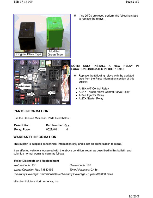

2008 Lancer TSB - No start in cold
TSB number 07-13-010
See images
Attached Thumbnails 2008 Lancer TSB - No start in cold-8.gif   2008 Lancer TSB - No start in cold-9.jpg

Originally Posted by cRc`22
my car hasnt started about 3 times but the temp is no where near freezing.. minimum temp when it hasnt started was 55.. so would it be the same problem..??
Couldn't hurt to bring the TSB in and have the dealership check it out. It IS their job to look into it...

since you washed it, and however the roads may be in your area...(salty/sandy in winter) moist? Anyways either way it sounds like a relay thats not really made for outside weather but put in the outside environment! Sometimes mitsu is smart, I swear!
But it could be just a relay problem(moisture, not just cold freezing). At least get them to supply you a relay and replace it yourself, unless you and them both have the time.

Originally Posted by cbenite1
okay so my car didnt start once.. the replacement is free if you're within the affected build date?
I think you're jumping the gun a bit. But if you're within the build date, your dealership can replace them for free, yes. But I think you'd have to ask them to check it out. This isn't like a factory recall where they replace the faulty part on every car. This is just a fix for cars that have problems.
Your car not starting once isn't a serious problem. Your car not starting AT ALL is.

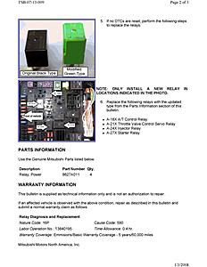

yeah mine has done it probably 6-10 times over the time ive owned it since june and in all different kind of weather situations. when i go to get my oil changed in a few weeks im gonna tell them about it. where can i find the actual tsb to print it up and show em though? i feel like if i just tell them about it they will just be like "ugh the car is supposed to do that, all cars do that sometimes", friggen idiots.
Old Mar 21, 2008 | 10:43 AM
Blacksheepdj's Avatar
iTrader: (88)
Posts: 8,733
From: Concord Township, Ohio
Um, it's posted at the top of this thread. They're actual images of the TSB. Just print the two pages out and take them in.
