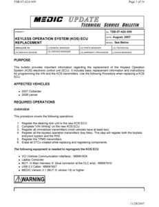

2008 Lancer TSB - Keyless Operation System ECU Replacement
TSB Number: 07-42A-009
See image (pages 2-14 not included because they are step-by-step instructions for service employees; PM me if you need them)
