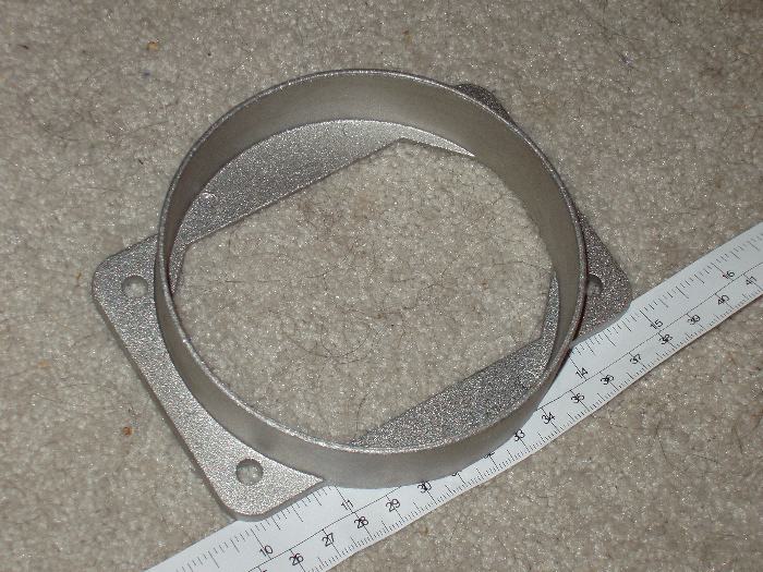

how long can i drive without the mas plugged in......and also how did u guys connect the mas to the filter??? i drill a hole on the filter then screwed it. and show pics i see likes alot better then what i did

you need a mas adapter plate. if you want i can take a pic of it for you.

yeah can u??? and where can i get that??

here is a pic of what you need. this one is metal, but you can also get plastic. i highly recommend you get the metal one cause the plastic could melt and get in your engine.
billy (Link286XT) installed mine, so you could pm him on where to get it, unless anyone else reading this knows where?
