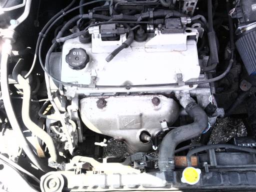

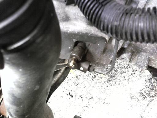

Here are a few.
The one named bleeder is the only spot on my tranny that looks like a bleeder spot. Located directly in front when looking under the hood.
I have also a picture of some sort of cylinder bolted near my radiator. I have no clue what it is or what it does. (im a noob, sorry)
I posted a picture just above where the battery, intake, and tranny are located, could you pinpoint to where I should be looking for the bleeder, and filler plug.
After further inspection of the car, the intake manifold, exhaust header, and exhaust seem to all have been replaced. My car is a theft recovery tho.
Here are a few.

your car looks stock to me man... except intake
and you have air conditionning i suppose? then thats one thing that mesmorizes you lol
i know theres alot of wiring on this car but hey its fun to drive
And I know it looks stock, but it looks like a lot of the stock parts have been replaced with other stock parts, just different levels of corrosion, rust, etc.
