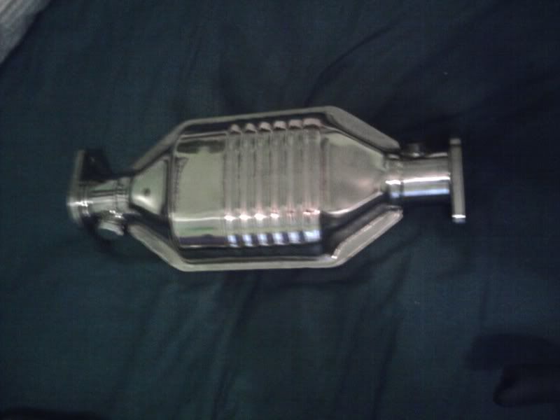

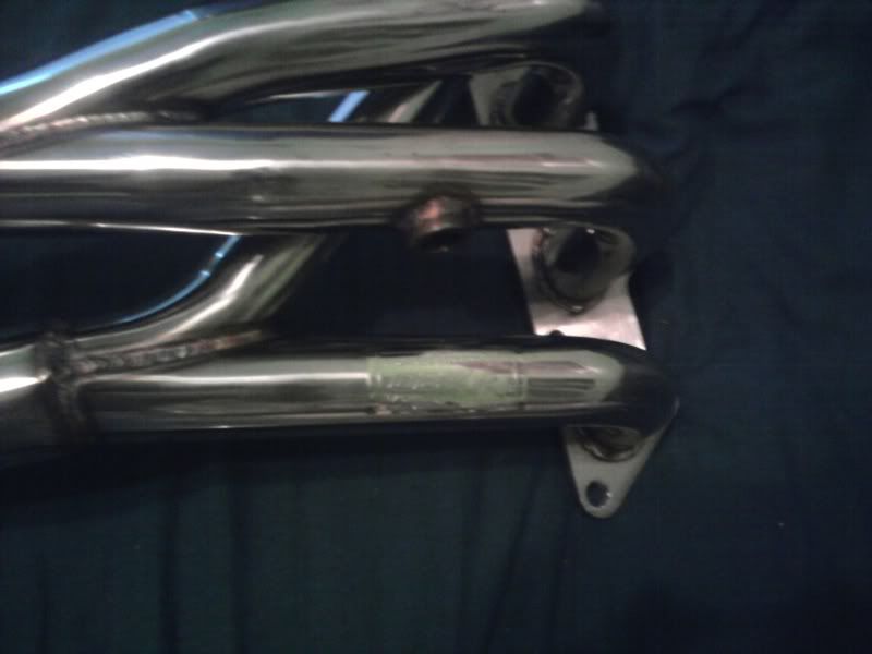

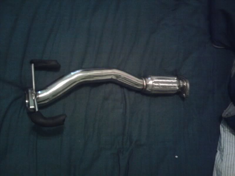

Just purchased a carport and full cover, and am getting ready to put the car up this weekend.

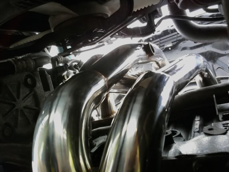

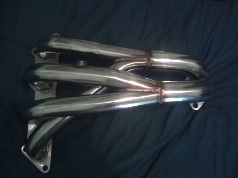

Got a few goodies in the mail today, thought I would share. Can't wait for the catback to come! Still wondering what im gonna do about the o2 sensor situation, trying to read about the RRM CEL eliminator and other products, anyone have reviews or suggestions (anything appreciated, even critical, **** you too (: )
Here is the new OBX Header, DP, and High flow cat I got today, (Only camera I have is my phone)

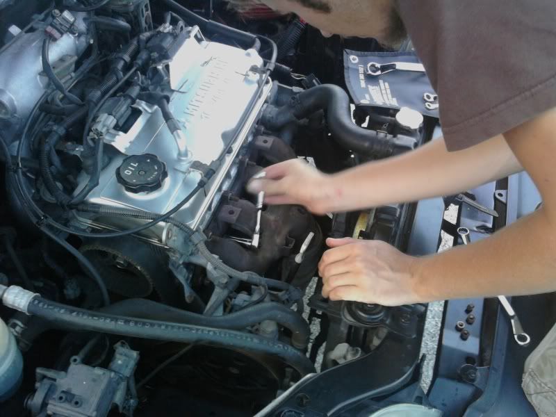

And a pic of my buddy working on taking out the old header bolts.
Thanks to Green Bandit's great how-to: https://www.evolutionm.net/forums/la...6k-no-way.html
The "peel back" helped so much, the note of "nut from hell" made me laugh so hard cause that's what all of us were thinking when we were trying to take the header off.

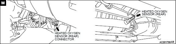

EDIT: I just found this after scouring the service manual, this is pretty much exactly what my setup looks like now, so im gonna keep it the same with the o2 sensor BEFORE the cat. Any input?

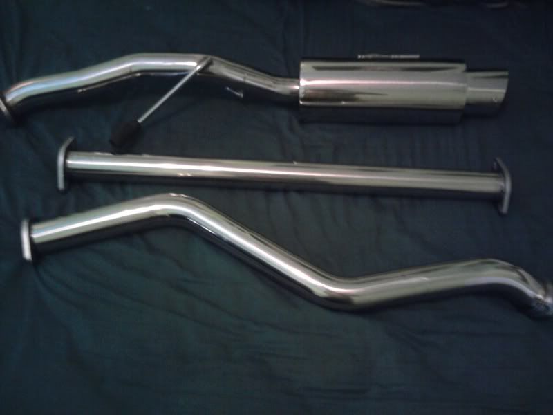

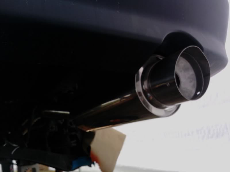

Update as well! Just woke up to find this lying outside waiting for me! New SRS N1 Catback exhaust system. Gonna keep the silencer and hope its quiet.

I only owned a 2000 Toyota ECHO before this Lancer, for Christ sake that's barely a car. This Lancer is the first car I have ever worked on so far, but it has been fairly easy and a bit fun, its all coming together quite nicely now. I cant believe how flush the exhaust tip is now, It used to sag like my grandmothers tit.
EDIT: This is pretty much exactly what my setup looks like now, so im gonna keep it the same with the o2 sensor BEFORE the cat. Any input?
I cannot find anyone who will explain to me why the manual says in some parts to put the o2 sensor before the cat, and sometimes after. Any help appreciated, were going to install the new o2 sensors today . pics later

there are 2 o2 sensors, one is screwed into the header and the other is right before the cat. Since your new header doesnt have a precat like the factory ones do, you will probably throw a cel for the rear o2 sensor. Thats where an eliminator comes in, it makes the ecu think the rear o2 sensor is recieving less airflow than it really is. once you get it up and running go to autozone or use your friends scanner to see what code exactly you are throwing, no need to spend 70+ bucks on a front o2 if its actually the rear o2 giving you trouble.

theres 2 cats, a precat in the manifold and a catylitic converter in the exhaust piping, which is the one that is under the car. one o2 sensor goes before the precat on the manifold and one goes after the precat, but before the convertor on the piping.
Thank you, your the first one to properly explain this to me. I really do appreciate it man. Got my baby started up tonight, will post pics later.
Also, I installed the new o2 sensors in their positions, first on the header, second before the cat. I started the car and my check engine light went OFF. I'm very satisfied with my install and the car sounds good!
