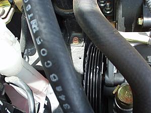

hey guys, well ive had my first pain in the *** today, let me tell the story, every day before i go to work i start my car and let it warm up, i started my car and i heard a strange rattle comming from under the hood, so not being in a hurry for work i decided to check it out, i opened the hood, the sound is gone, but heres where it gets messed up, i put it in gear and i proceed to the freeway (its like 50 ft from my house), i get on the freeway and im driving, so i turn the a/c on and all ofg a sudden POP from the engine bay, *$&*^, what was that, i lost my a/c and my power steering, so i pulled over to a gas station, and poped the hood, crap my a/c - p/s belt broke and 2 pullies are damaged, crap crap crap
so im like 45 min from the nearest dealer

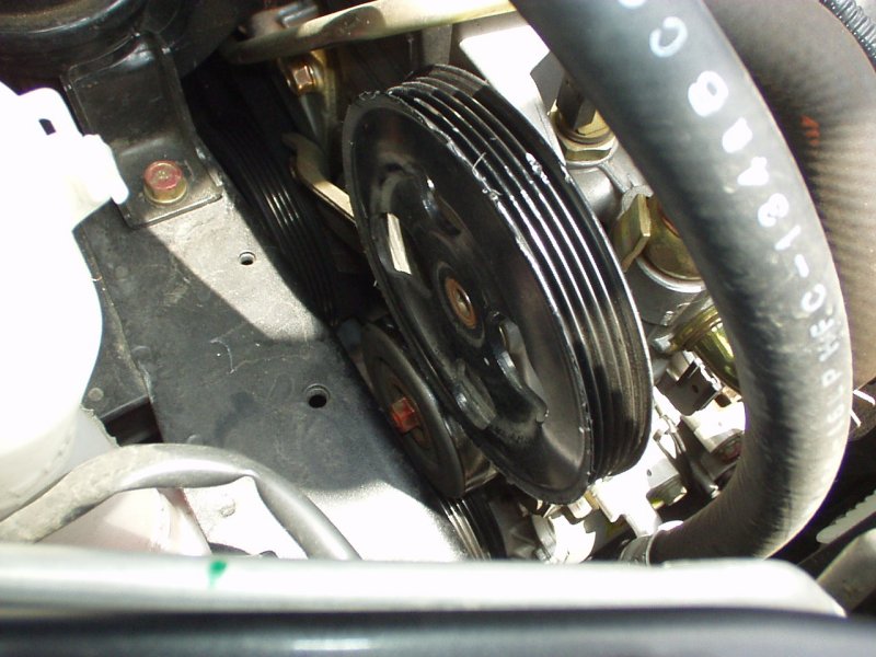

so i start heading there, (the car was ok to drive considering the belt had no vital importance, like water pump belt or the ALT belt) so i drive to the dealer, they check it out, the main mechanic immeadly says it was my after market car alarm, i promptly tell him its not, there no wires that go thru the fire wall for my alarm, so we bring another lancer and take a look, yup theres a black/yellow grounding wire that is less than an inch between the wire and the pulley, i know the people at the dealer, they help me with my questions and help me get some parts i request, so they help me out and decide to cover it under warranty, woohoo!
so now its getting fixed, susposedly its going to cost around 600+ to fix, thank god for the warranty!
but anyways, im lancerless for the next week, im so sad
but a friend of mine there offered my a rental car, so i said ok, the only car left was a geo metro, i said hell no, my friend spoke with his boss, and they rented me a brand new 2002 Montereo 4x4 sport limited, fully loaded, soo &^%ing sweet, but i still miss my lancer
oh well im just ranting

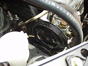

the maddedst props go to Ventura Mitsubishi, they rock!!

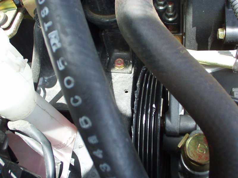

so in the end all i have to pay is the gas i used in the montero
