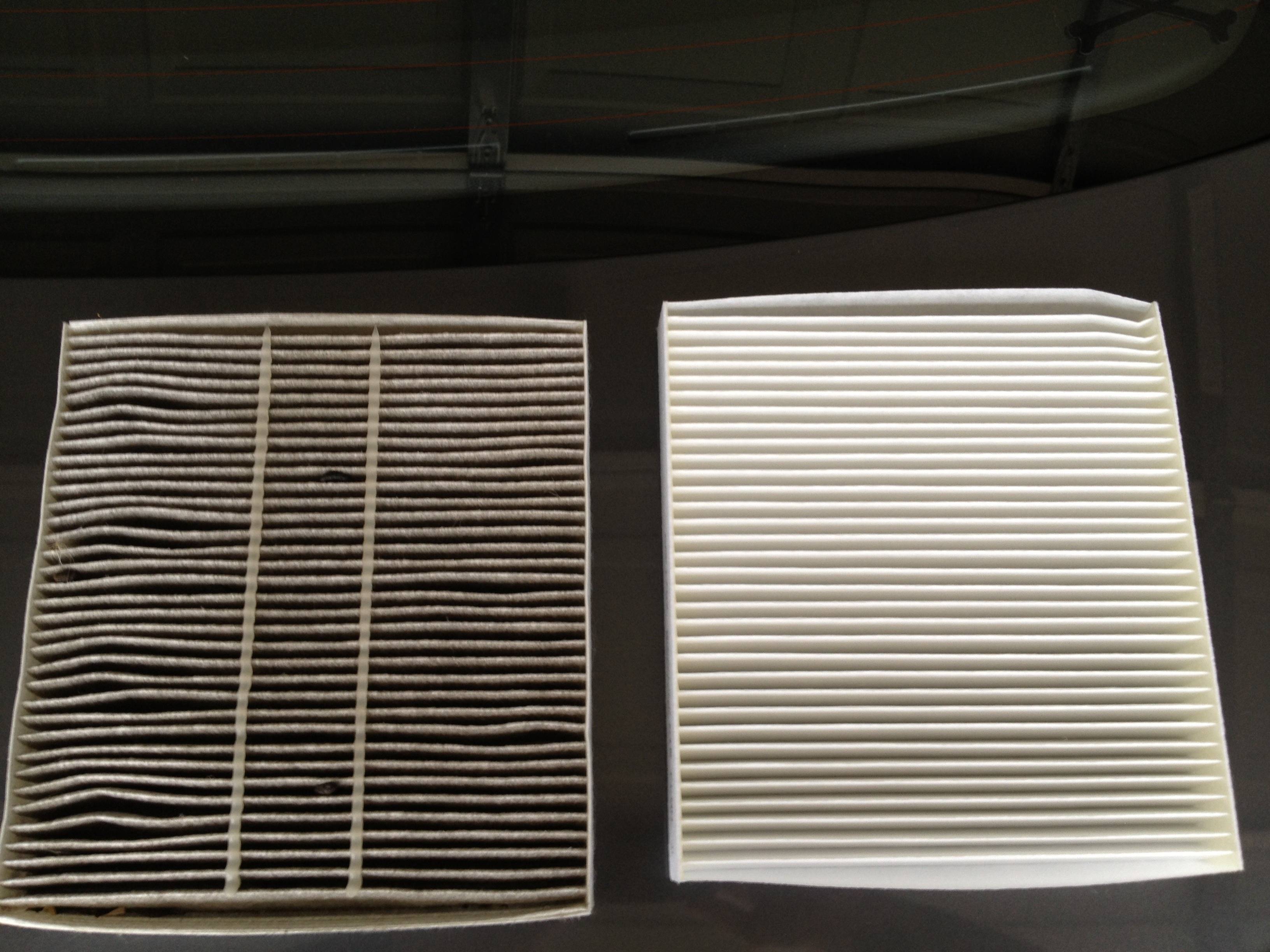

Came across this thread and thought I would share my mouse **** experience in the in-cabin filter as well.
Attachment 334024
Attachment 334025
