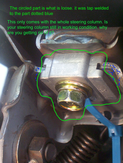

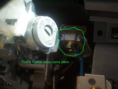

ok heres the pic of whats wrong with my steering column

That's an odd part to have a problem with. How did it get damaged?
Just so you know, the piece you show circled in the picture can't be welded to the other piece. The circled piece is aluminum and the other is steel, these two metals can't be welded together. I'll look at it tomorrow to see how it could come loose, but I would suspect the aluminum piece just gets crimped into place on steel part. I guess the steel piece could have gotten bent some how and loosened the crimped pressure that holds the aluminum piece in place.
Either way, that part is fine on the collumn I have.

it started after i hit a pot hole... guess that did it.. the mistu mechanic said they were tap welded together.. whatever that is.. but yeah i see what you mean.... im not sure but i can pull those peices out easily.. adn they keep moving forward allowing the steering wheel to move side to side.. Thanks alot for you help....ill show my dad the pics and whatnot and theres a 99% chance ill be buying this.

This is the best I can do with the pics I have to show you that part on my collumn.
If I try to zoom in anymore you can't tell what it is.
