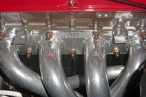

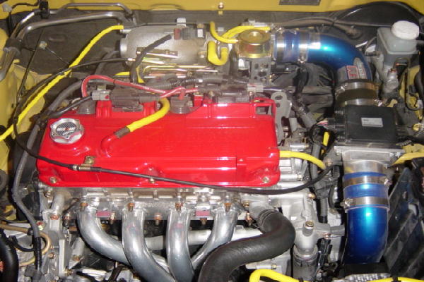

Got my header installed today, love the way it looks and sounds, but one small glitch, feel a very slight difference in high rpm power, a lot louder at high rpm, but I can hear this little whistling sound, and almost a little rattlish at the same time, I'm 90% sure it aint an exhaust leak, cuz there's no funky smells at all in the engine bay, or underneath the car. I followed rrm's torque specs to a T. Anyone else noticing this with the header? Any help is appreciated. Also, here's the pics.

little colorfull engine bay...weird but i like it

Thanks, but totally not helpful, the intake's gone when the turbo get s here anyway, that's what throws the color scheme off.
