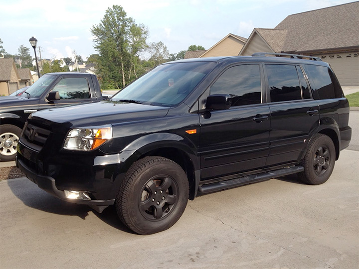

I really want to do my tarmac black in matte white. I noticed your in New Hampshire, pretty cold up there this time of year, right? You do this inside or out? I did the grill of the wife's car as well and leaving it direct sun light seemed to effect the dip some as it has some imperfections, even with 5 coats (yeah went overboard). It was in the garage but the front was slightly exposed to the sun. I cleaned it really well, wondering if it's a combo of the plastic and heat from the sun?
Here is a pic of the wife's. Wheels, grill and rear emblems are "dipped."
