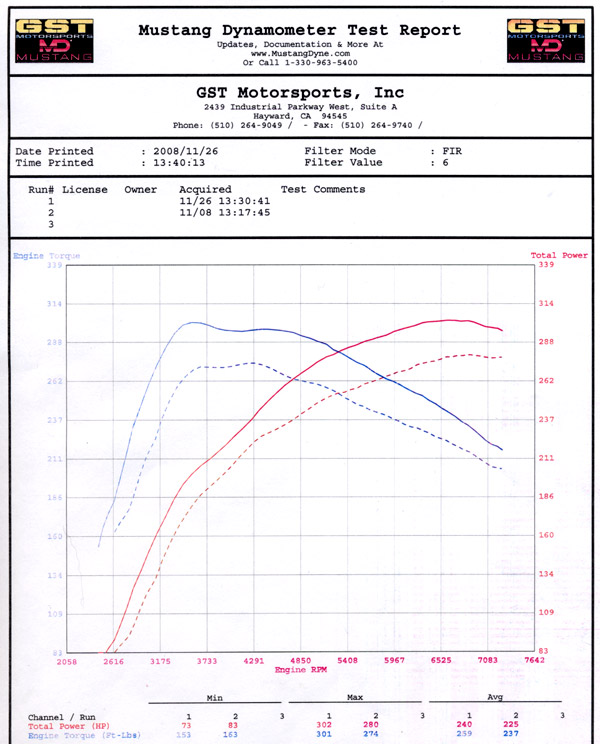

Originally Posted by tephra
if someone has time can they do a tuned stock VS tuned HFC/testpipe dyno (or VDR) log?
that way we can put to bed these claims that HFC or testpipe make a big difference
here you go.
Stock cat vs Test pipe, just bolting it on.
Old Jul 6, 2009 | 07:29 PM
tephra's Avatar
Joined: Feb 2007
Posts: 9,486
Likes: 67
From: Melbourne, Australia
Cool.
You got a boost/afr chart to go along with that?
Cool.
I'll try to remember to print it out this week. The weirdness up top was some knock and error correction kicking in.
I installed a boost pill and went on to tune it for pill and the test pipe and it ended up doing this:
-bryan
