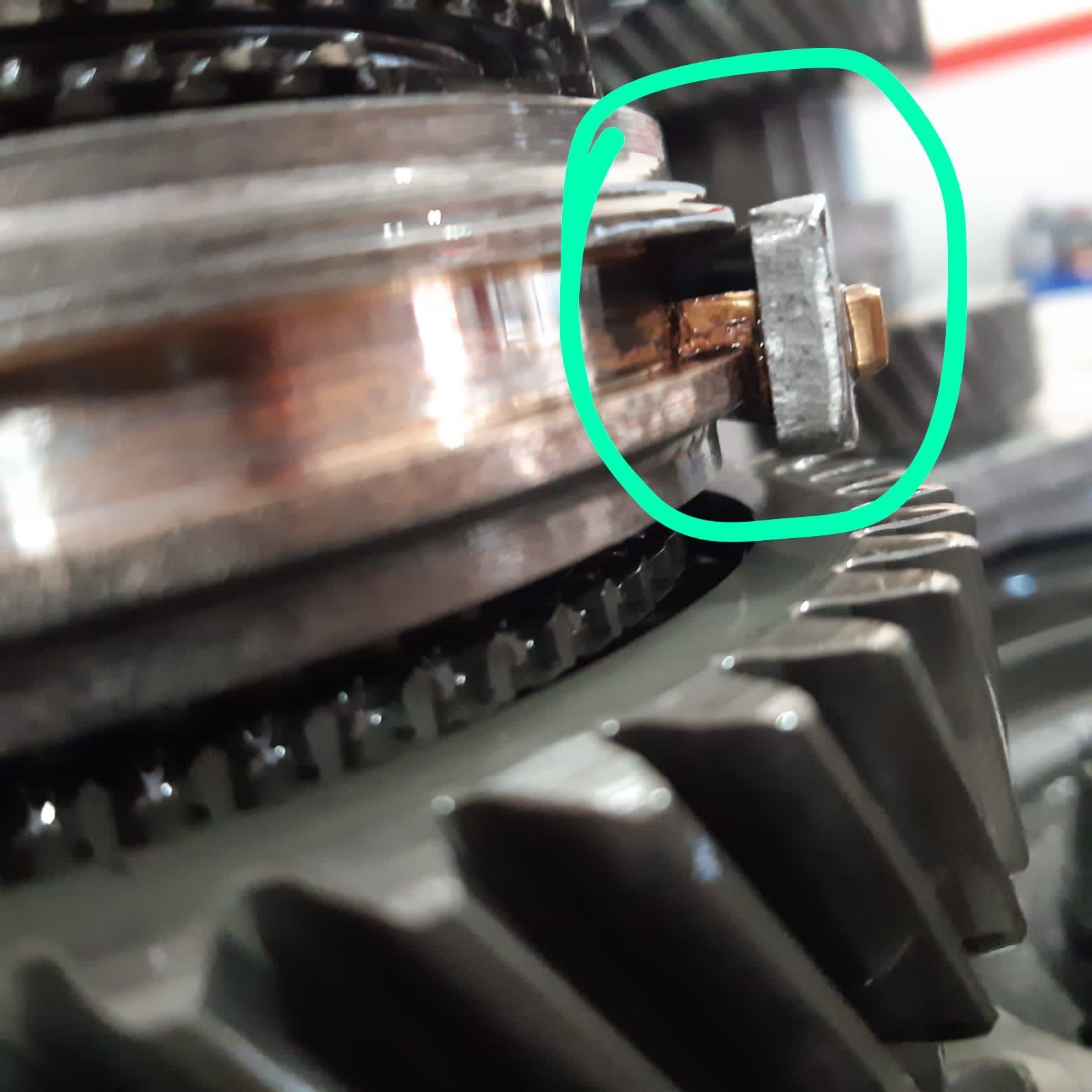

Hi. Has anyone had a problem like this and know the cause of it?
This piece wore out on the sync sleeve.
Thanks.

I would guess somebody resting their hand on the shift knob while driving, pushing the fork onto the sleeve while in gear. It's a silicon bronze bushing and it can be replaced.

But the gearbox is an SST, electronic the shift.
