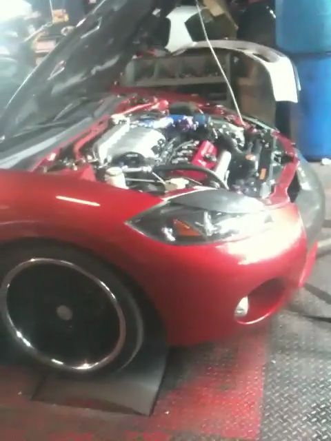

406 whp at 8 psi as of 3/23/12

ENGINE
Ross Racing 8.5:1 forged pistons, Brian Crower H beam rods, Throttle Body spacers, Ripp Supercharger Stage 3, Spec Stage 3 clutch, Greddy Type S BOV , Front Mount custom Intercooler, Meth Injection, Poly Motor Mounts, Torque Dampener

AEMFIC w/ Brian's Harness, 565cc WRX Injectors, 8 psi DRT Tune

METH INJECTION INSTALLED IN THE REAR
NEW ENGINE FORGED BOTTOM END
OLD PISTON detonated
