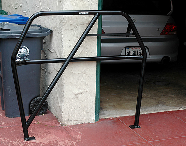

Yes. he has the race version with harness bar option (horz bar that goes across. Make sure you get the non-removable bars.
Looks like this:

The one bad thing about the autopower bars is that the main hoop only mounts to one surface, which is the floor. The floor thickness isn't that much and would probably be the first thing to fail. The worst case situation would be having the main hoop will poke through floor in a roll over.
Here's a picture of how the main hoop bolts to the floor on my roll-bar. Plates have been welded up from the floor. So the load from my main hoop is distributed over several surfaces.
Old Jul 18, 2006 | 01:48 PM
broeli's Avatar
Joined: Jan 2002
Posts: 1,803
Only two bolts per plate holding it in? I would think they'd make it so it could be bolted on each side of the bar.
Old Jul 18, 2006 | 01:49 PM
marksae's Avatar
Posts: 2,995
From: SF, CA
There are 3 bolts per plate. You can't see the other one.
