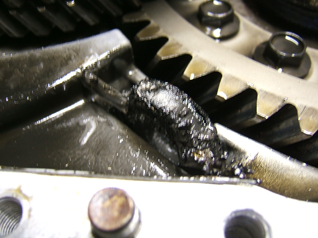

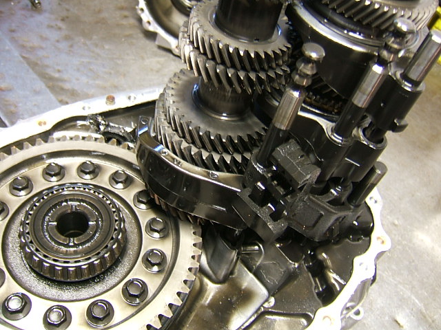

Ok, got the photos. MMMmmmm

wtf is that little black booger in the 3rd pic? It looks like a tooth fragment is stuck to it... Is it a ring magnet or something?
