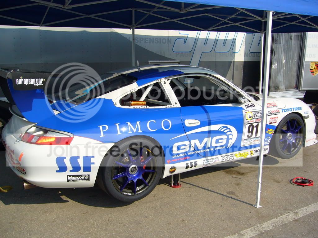

Any idea what caused the oversteer tendancies? Is this the first time with that wing?

The oversteer issue started when Daddio was at VIR last month, he told me it was wicked, and the wing that's on the car is brand new.. the splitter we have been running off an on since One Lap, so that's not the issue. (though lowering and playing with the car and getting more downforce out of it has) We had the GT500 wing on the car, and thought that it was probably too much drag for the amount of downforce it produced. We went with the modified OEM wing, which didn't work, now we are on this one, and it still doesn't seem to be helping.
I am also no convinced it is just the wing, because of how it changed during the day despite us making changes. (for instance early it was only high-speed, in the last session it was everywhere.
