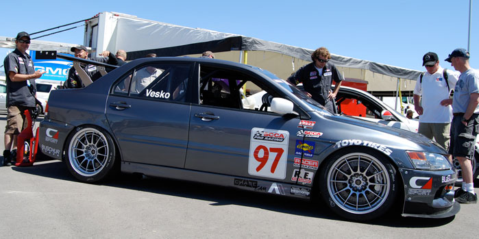

Aluminum can work for the splitter, you just need the correct alloy so it's stiff - but that's $$$ too. And it ends up heavy. If you look around club racing leagues you'll notice a lot of cars use 100% organic splitters - plywood. Call it ghetto but you can build and test alot of splitters when they're made out of plywood in your garage and painted black with the Krylon touch. Here's an example of a car running a plywood splitter.
