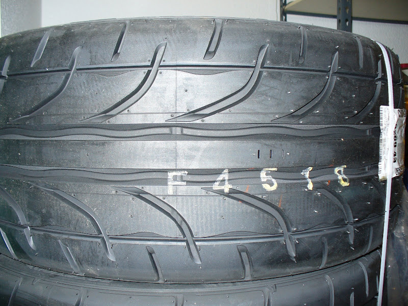

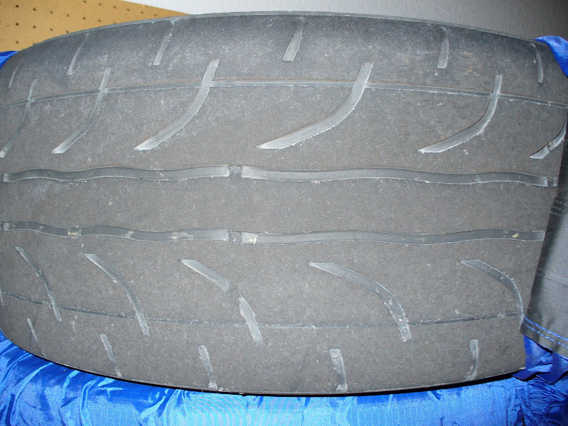

Has anybody had a chance to test shaved vs full tread Dunlops back-to-back?
I'm guessing most here either read or heard about the test Sportscar did last year where full tread Bridgestones were faster than the shaved version, but that tread design doesn't seem to benefit as much from shaving as the Dunlop does.
Pics for reference:
It's pretty evident that the Dunlop is putting more rubber down at low tread depths, but what kind of time difference this might make, I have no idea. I'm interested to hear what others think. Any kind of speed difference eventually leads into the value discussion as well. At a cost of $100/set plus reduced tire life I might do it just for nationals if I'm only gaining a tenth, but 3-4 tenths and I'd consider doing it for every set.
