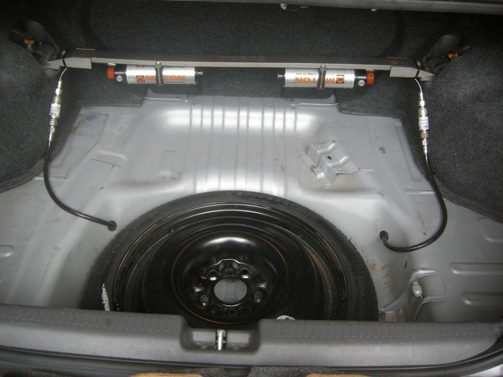

Coilover install
After getting the clutch broken in, I dropped the car back off to get the coilovers put on, get an alignment done, and get a baseline dyno done to see if the car was making the power a stock Evo should.
The install was very clean -
The shocks appeared to be set to the default Clubsport settings:
http://www.hi-impact.org/ryang/modif...Club Sport.pdf
Compression 2/7, rebound 3/7. Gotta start somewhere.
For alignment, I started with -3 f, -1 r and 0 toe. With the CiroDesign camber plates I had +4.8 on one side and +4.9 on the other. If the car needs more rotation and tire pressures/shock settings don’t do it, I have a WORKS rear bar waiting to go on.

I've got the full 12 puck build. Not sure if that's legal for STU??
