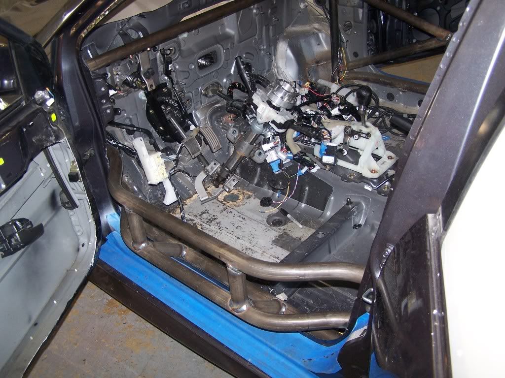

In looking at a lot of interior pics of caged Evos, it looks like a majority are NOT cutting the doors and doing the Nascar ladder-style bars. Why? I know this is an added cost, but it is that or just because the extra interior room just isn't needed?
Old Feb 15, 2012 | 12:28 PM
apex electric's Avatar
Posts: 761
From: East Hampton Ct.
It is a complicated job designing the cage to accept door bars around or through the B pillar. I have a NASCAR impax foam door piece but have not installed yet. NASCAR uses sheet metal to cover it but we were thinking of bonding it with fiberglass or carbon fiber onto my Seibon door.

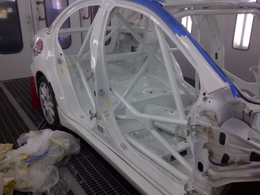

it is harder to get out , but a same time supposidly much safer.
I mean it is actually harder to get out obviously but for rally you need this bar , other wise you will not pass inspaction.
this is a fairly proper rally Evo X cage
