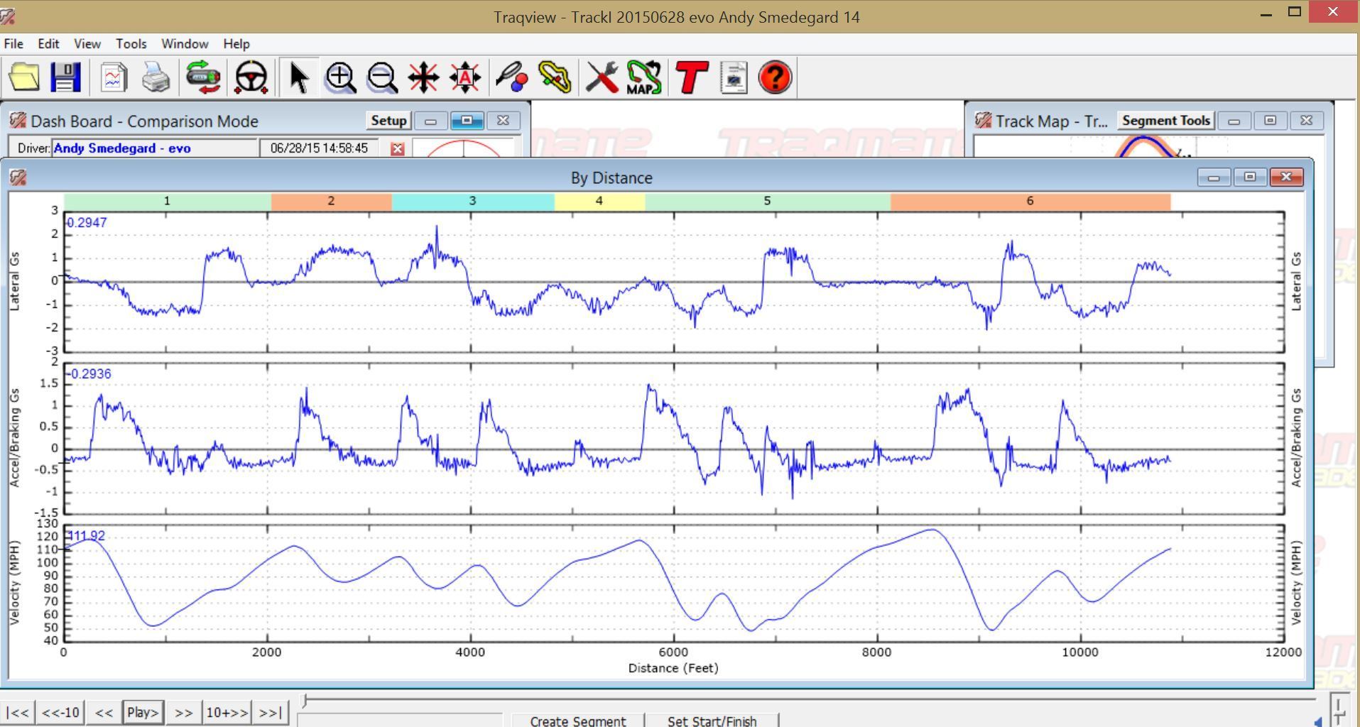

There, now I can claim 2G's. lol. All I did was turn all filtering off.
