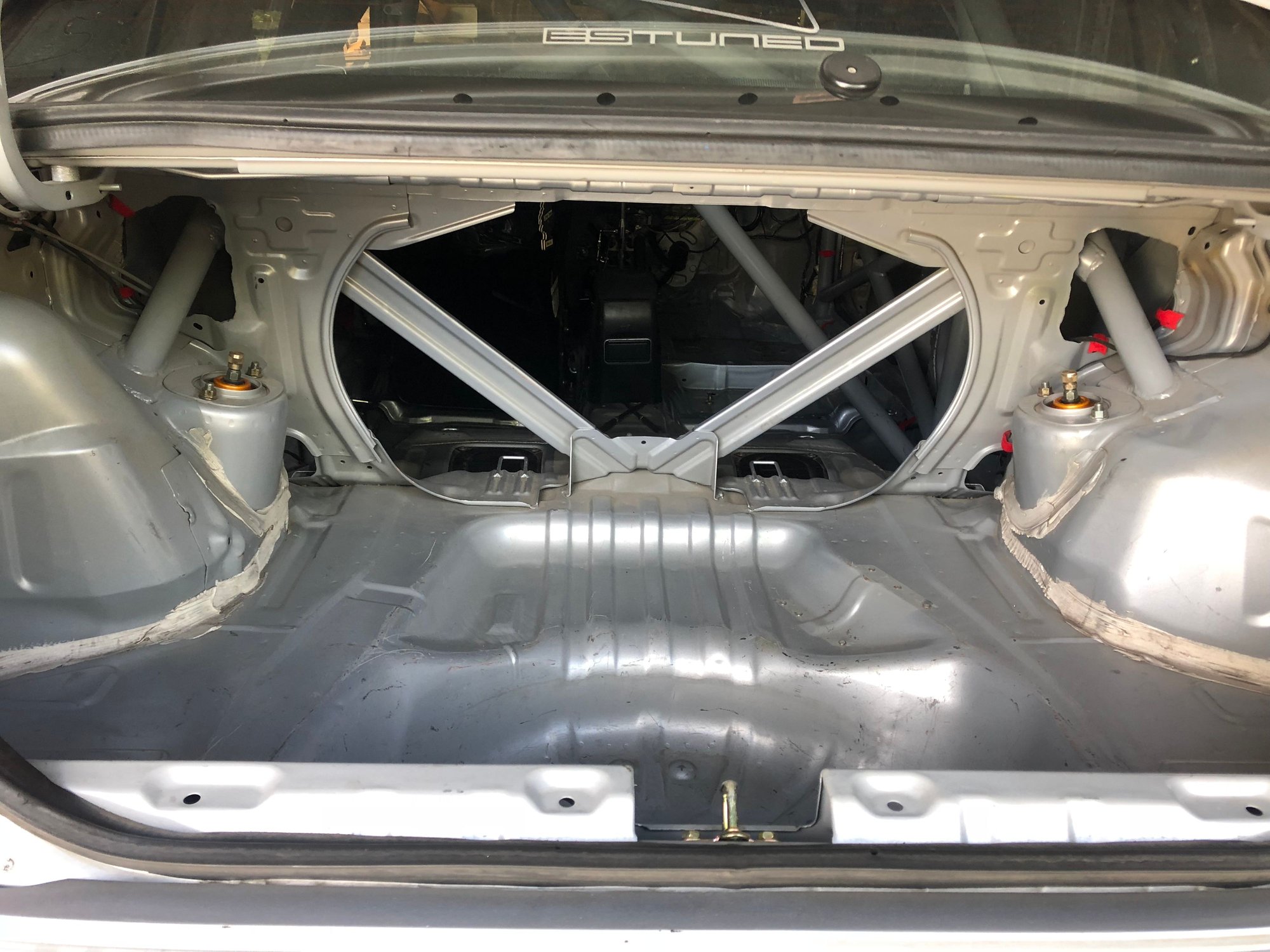

^Can you post more pics of how your cage ties in the rear? Perhaps I should start another thread but your picture piqued my curiosity. Id love to tie into the rear towers but Im not sure that's feasible. Previously folks would run a bar across to tie the two towers to each other then have the diagonal tie into that but I'm told that is no longer kosher.
I mainly skipped on the tie due to SCCA rules, at the time, forbidding that tie in point. Pics can be found here: https://community.drivenasa.com/topi...comment-155562
Way late here, kept forgetting to take a photo. To tie into the rear towers you need to make holes
