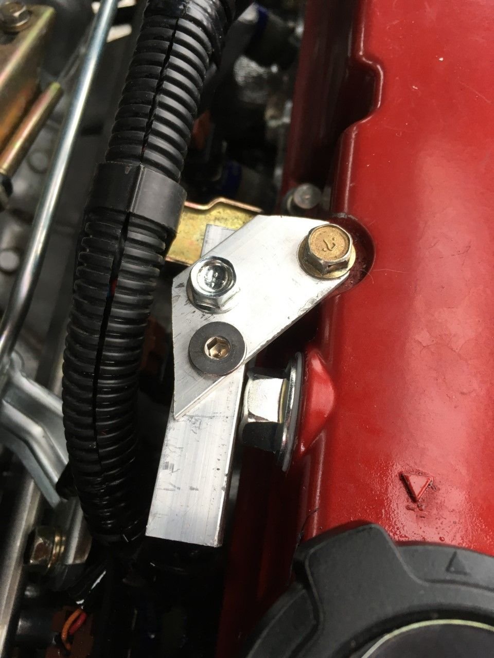

Come Saturday morning I find that my 429,389th revision to using a catch can on the back port was a bust yet again. Oil everywhere out of the filter/vented port. Ok going from 6an to 10an on that port made things worse, not better. I can only imaging at this point how much oil the Recirculating setup sucks into the intake... Even with a MUCH better designed can. So clearly the port is the issue, F it, so lets plug that. I set about digging into my AN stash to rig up a short hose with plug about 5" long off of the STM 10an fitting. RTV'd and banged it in about 1.5 hours before our first session. On top of this I put a metric ton of 5min LocTite epoxy on the outside just because. Come to the session, get all geared up and go to grid, all readings normal. First lap felt great as it would right it's your first one since last year feeling the Boooooost. Come around the 3rd lap slowly increasing speed on the 285's I smell oil....badly. I ignored it at first because I wanted to see what she'd do. About 3/4 of the way around Road Atlanta I lock up the front left tire coming into 10a, puzzled wtf comments here. Not knowing if it's the RX7 in front of me dropping oil or me, I pitted next time around and was shocked to find the whole DAMN THING was missing. fitting, hose, the works. Somehow it blew out on track. I go back to the dash panel and see the ABS light is on....great.
Over the next 4 hours I manage to run home, find a spare ABS sensor (not knowing which one it was) and ALL of my spare bolts. The wife set about disconnecting the front left sensor while I chose the Trans Fill Bolt as my temp plug/replacement for the back port due to it's size/flange/fit. I have my abs wrapped in fire sleeve due to lots of exp frying them before. Back on the plug Same drill, copper RTV and 2+hours to grid. Focusing back on the ABS she finds that the ground wire is severed at the top plug. Awesome, I have the spare part this must be it. Plug, tie, test and light goes away. W00t. Qualifying on R7's instead of A7's isn't ideal but it's what I have that fits atm, so we go for it. I managed to run 4 tenths faster then I've ever ran before on A tires going slower then normal because guess what I smelled around lap 2, moar oil. This was entirely due to the transformation SSBadass gives to the grip capability However this was still 3 seconds behind 1st on fresh A tires. No biggie I'm qualified 4th of 6 lets get this done. Come into the pit and the smell is worse. Open the hood and yes another big hole, another part missing on track, oil everywhere again. I'm down to my last 2 brake cleaner cans at this point of a 6pak. F*k. The only option is to let it cure I thought. This meant missing the Saturday race when it counted for trophies and such, in the damp, it was a shoe in win... To quote TopGun'ish, "better to retire, save the car, then push a bad position causing an oil spill or a blown engine." So I used my trans bolt off my spare transmission, RTV, let it cure overnight because the STM fitting stayed in there until I messed with it.
Qualifying Sunday. Everything looks good, suit up and qualify at 9:40am. This time I was sending it because I couldn't stand the thought of backing out at this point with such little time left and this Virus BS shutting things down. I told the wife "either we're getting a good lap in or we're blowing an engine." Of course she understood....ya right lol. Went out in a damp session on the R7's and somehow managed to qualify P1 in class by 1 second. Fearing the worst due to yet more smell, we open the hood annnnd guess what's missing. *@*#@& #&*$*$*(($T(R$T($)*@#($*#@$&@#$@*#&$@#(*$&@#($*&@# (*$&@(#*%!!!!!. I'm not missing this race, no way in hell. Knowing at this point it was pressure, combined with the weight of the bolt, the non-tight fit, and the uncured/weak RTV it was time for the Home Depot racing department. I manage to find another trans bolt in the oem bag and set about for round 3.

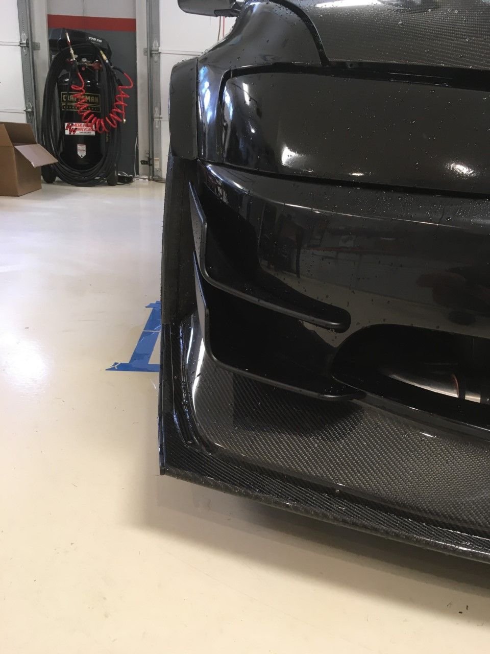

Nothing stock about those, Regular Voltex fenders and even then they poked at the front by a good 15mm. I'm attaching the Voltex over fender extensions to those now mated with their canards so it'll look quite a bit better. The 11"s are +15 so that they cleared brakes and everything without needing much spacer. I'm also moving to 5" springs up front to see if I can clear the perch and maybe use no spacers. If so I'll likely wanna sell my Eneki's and get TC105's all around to match. Those details later..

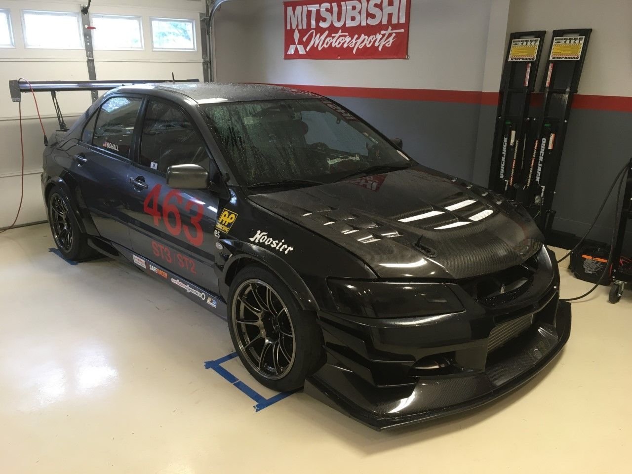

So, after TONS of hacking. 295's on 11 +15 TC105's at your service. This is with a 12mm spacer up front, 10mm in rear to see. However, after putting 5" springs up front I can now go inboard enough to run 0 spacer front and rear. So, as you can see now 315's are a reality unless Dallas comes in and says 11's are for losers and you need 12's lol. Damn I can't wait to get it wrapped. Should start a competition for the graphics/wrap and the winner gets a some racing parts.....

Looks great!!! What ride height are you at compared to stock?
