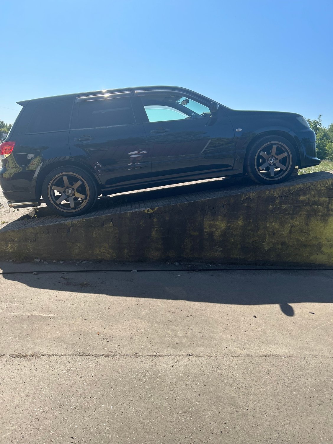

Hi and greetings from Sweden! Love your airtrek tog bad we never got Them here. But we have outlander turbo!. Could you spec THE shocks some more since modell and year seem to differ. Also if you would be so kind to spec length of sleeve and hardment of springs and length..best regards alfred
Hi, We didn’t get Airtreks in USA either, we didn’t even get Outlander Turbo!
The part number for the Koni civic rear shocks is koni 8050-1025. I removed the spring perch with a rubber hammer and used a clamping steel collar instead (the inner diameter is 1.75” or 44mm). The coilover sleeves are universal, they were a bit too long so I trimmed them to the right length with a grinder. You also need the correct shock tops to make these work. The oem shock tops makes the car too low. The pillow ball type that I used adds almost 2 inches to the ride height which was the perfect height for me. You can adjust the height a few millimeters using washers under or over the shock top but this setup is not meant to be height adjustable. I used 5kg swift springs in the rear and 6kg swift springs in the front.
here are some photos
I got the shock top from this coilover set. It was for a evolution 8
this is the type of collar I used
this is what my rear ride height looks like

[QUOTE=apoopoo999;11953855]Hi, We didn’t get Airtreks in USA either, we didn’t even get Outlander Turbo!
[/QUOTE
Wounderful ! Big Thanks !!
