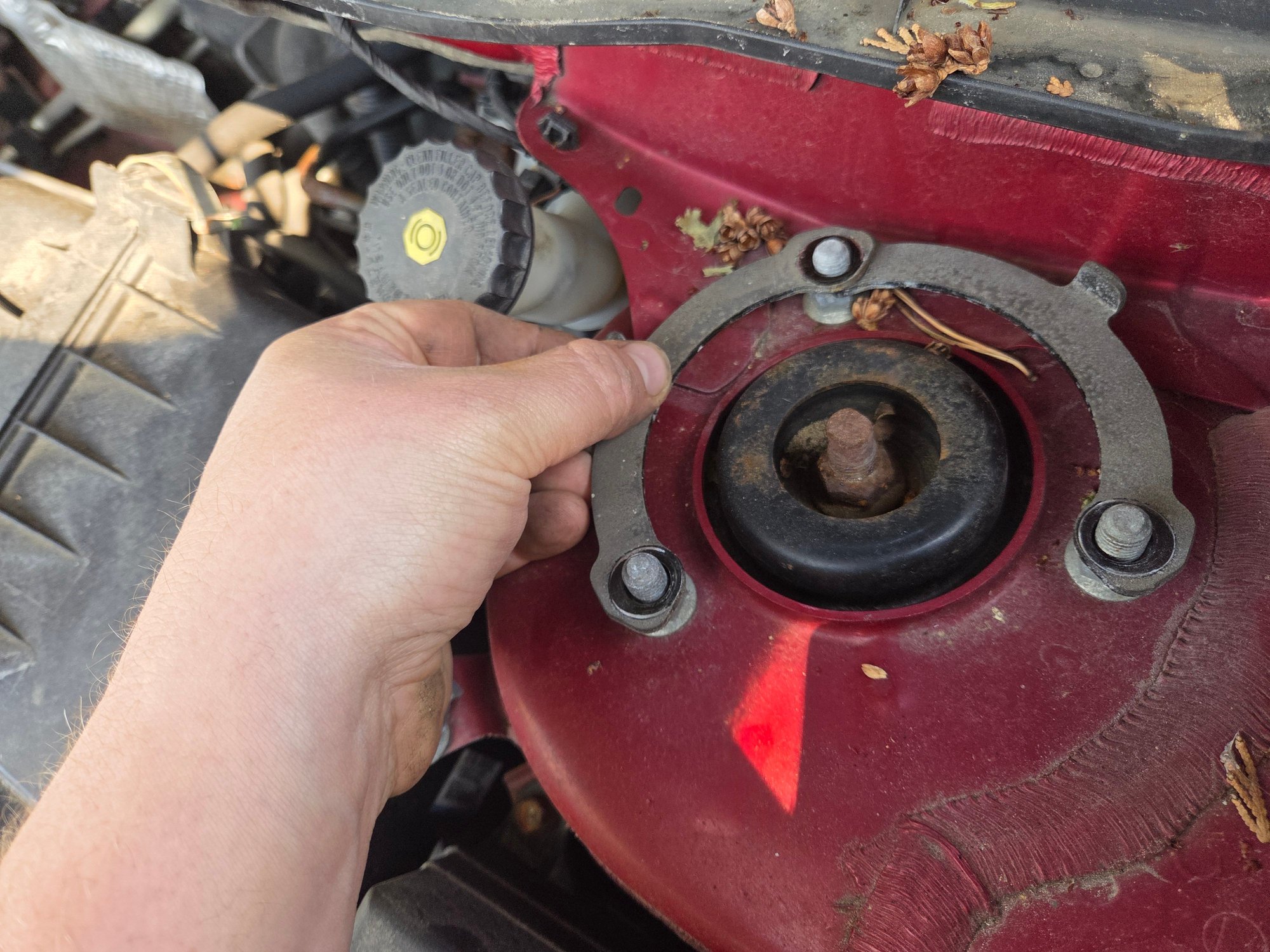

These are the strut tower spacers off the sonata. Same bolt patern as the OS. Unfortunately the sonata struts have a forked bottom attachment point like the 2nd gen eclipse. Im wondering if i could possibly swap the top hats of the sonata struts onto my evo struts but they might have clearance issues even if that could work. The sonata spacers were probably 2cm closer together than my evo's strut tower bolts

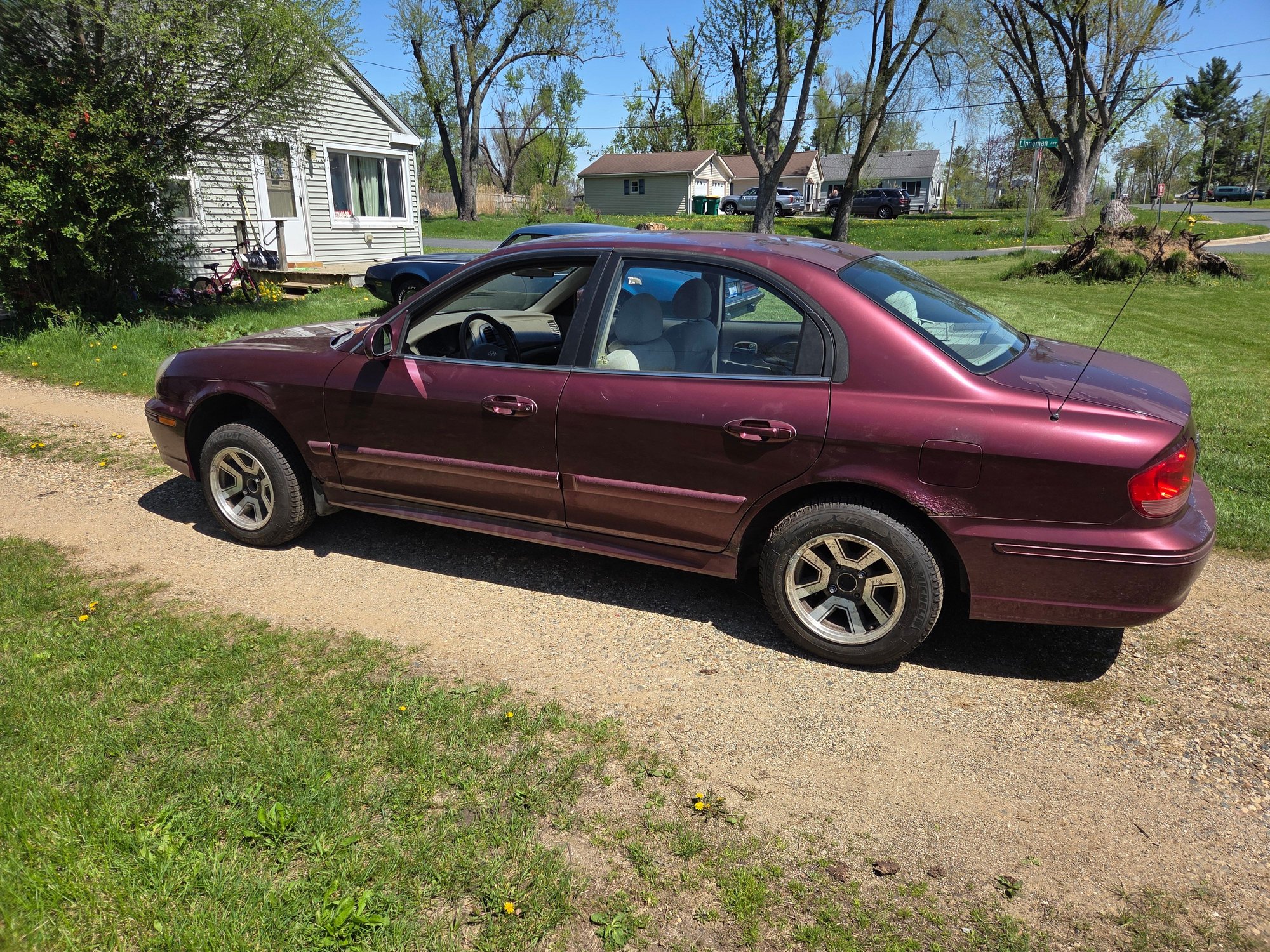

The sonata that has donated its 2.4 G4JS for the project. The current plan is to swap my evo8 head components into the G4JS head and run it otherwise unopened. It will be high compression but hopefully the hks272's will keep it happy even with boost.
