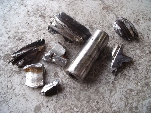

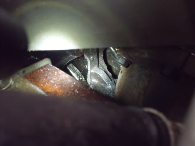

Back in April I managed to blow up my stock V engine whilst undergoing some CAT driver training at Millbrook. Cicky here to read about it
My car being recovered
The damage:
Now at this point I could of either fitted another stock lump or gone for what I always wanted to do.... a full on build

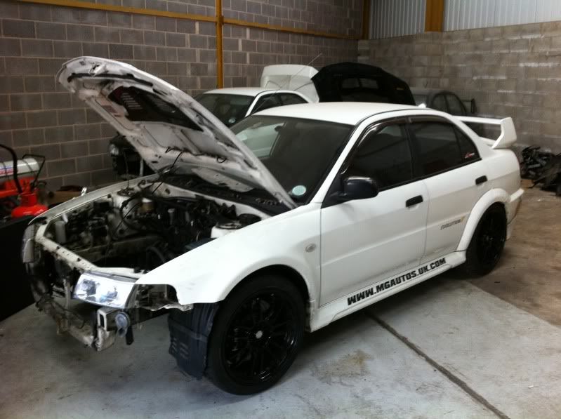

First up the MG crew whipped out the dead engine:

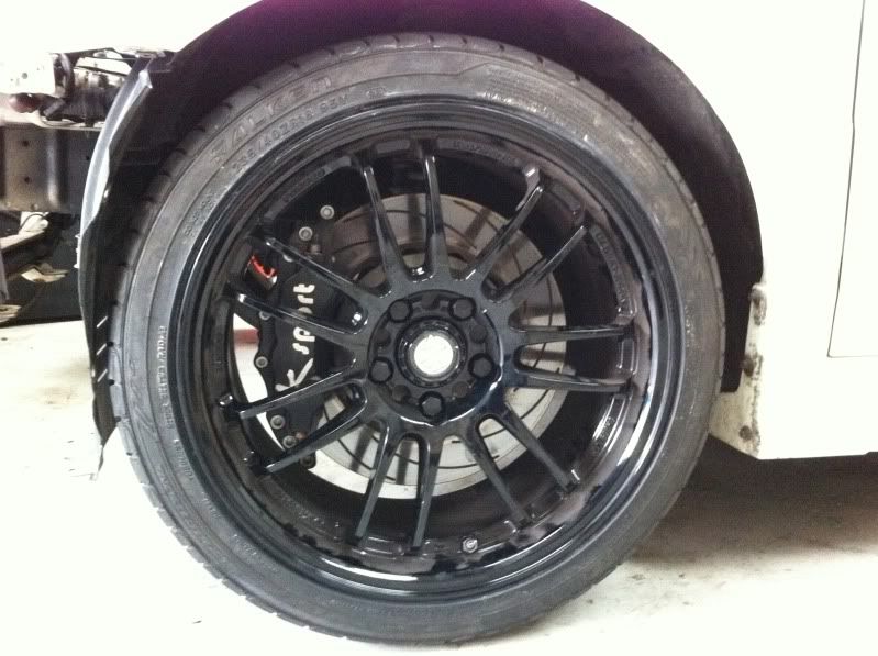

A bit of a distraction from the build.... I've just bought some Volk RE30 wheels (you can't really see them with them too well being black... I'll get some proper pics up later)

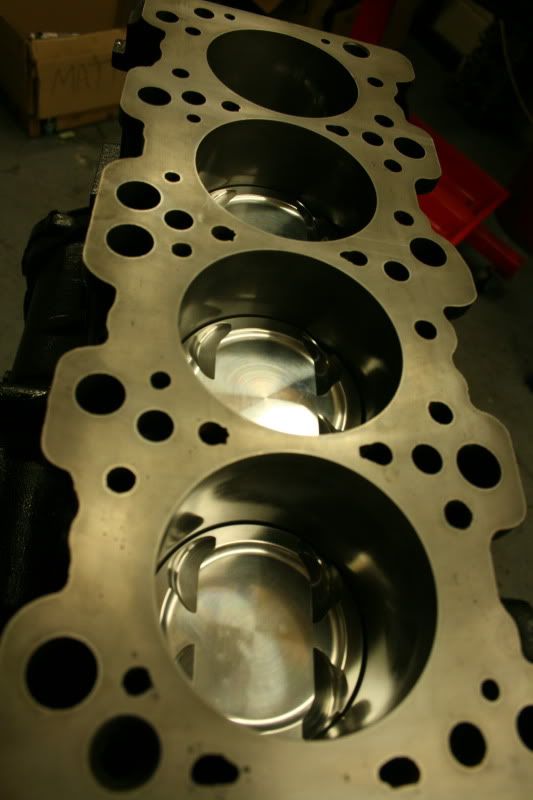

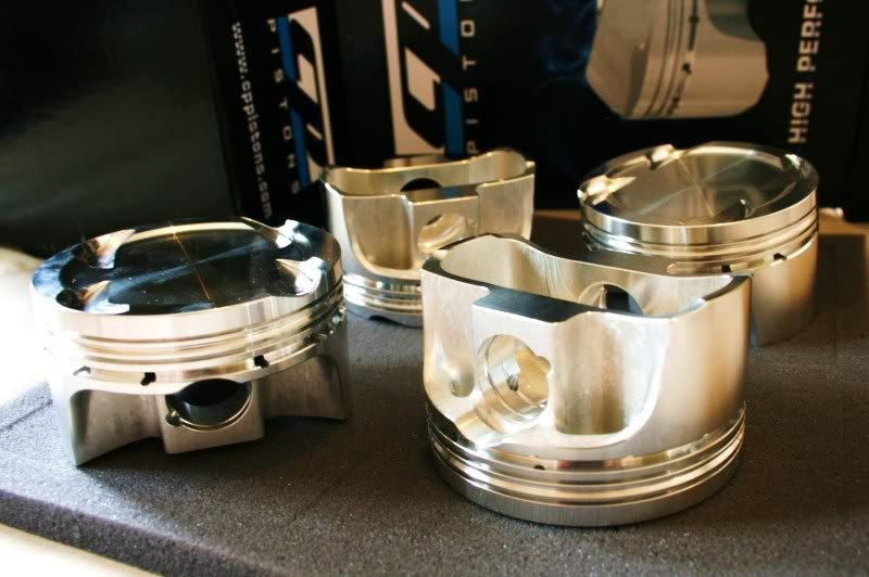

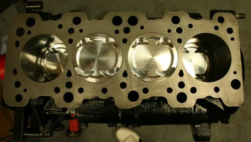

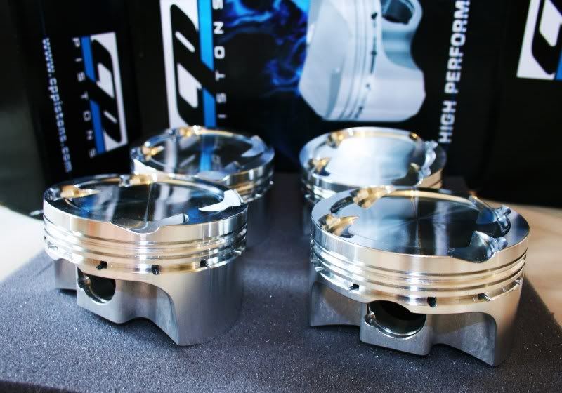

Next up pistons. After quite a bit of research I decided to go with a custom set of CP X-forging pistons (each one is a work of art):

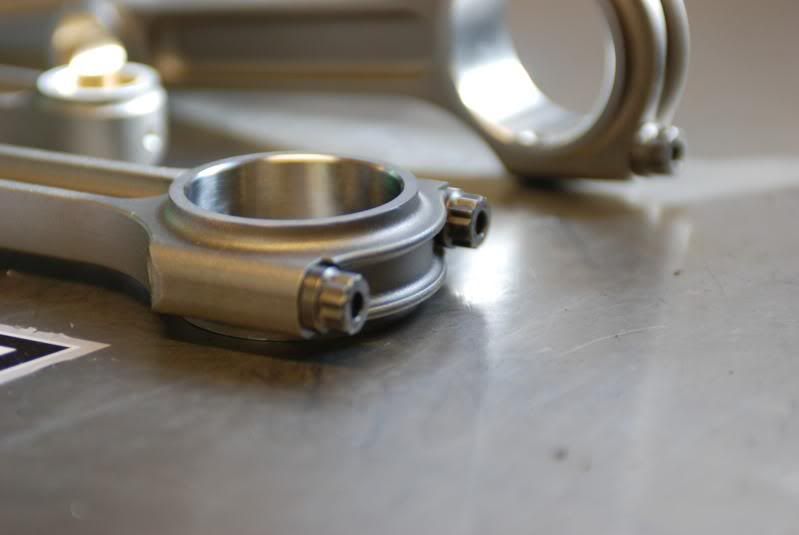

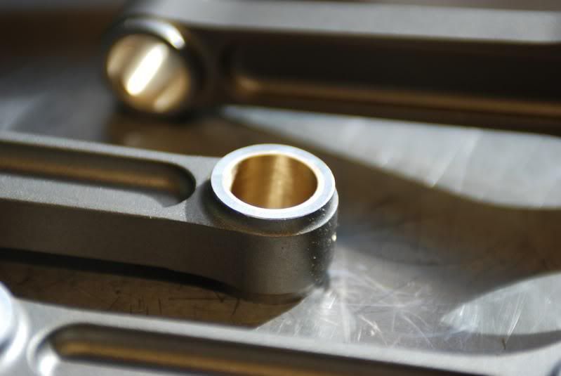

Next up rods. I wanted something that was strong and light. Weighing in at only 615g a pop and being able to cope with pretty much anything you can throw at them - I decided to go for a set of R&R Racing Pro Billet con rods.
Now these come with ARP 2000's rod bolts as standard. I'm going to swap these for a set of ARP custom age 625's.

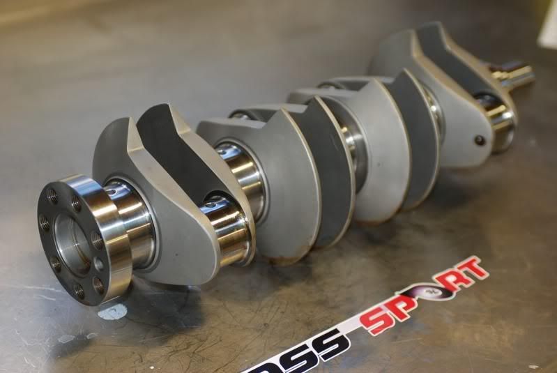

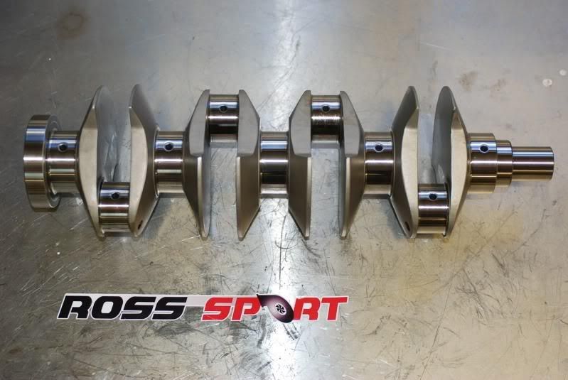

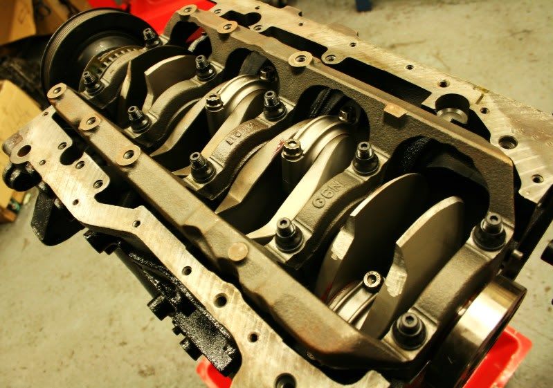

Next up crank - at this stage I had already spent a fortune on pistons and rods... why scrimp with the crank? I need a billet crank to match

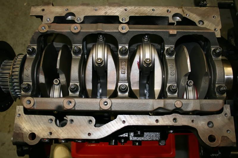

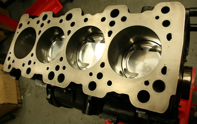

OK so with those bits I was ready to let MG Autos loose. The donor engine was stripped, block cleaned and sent away to their engine shop for machining and balancing.
Madmat then set to work putting the bits together:

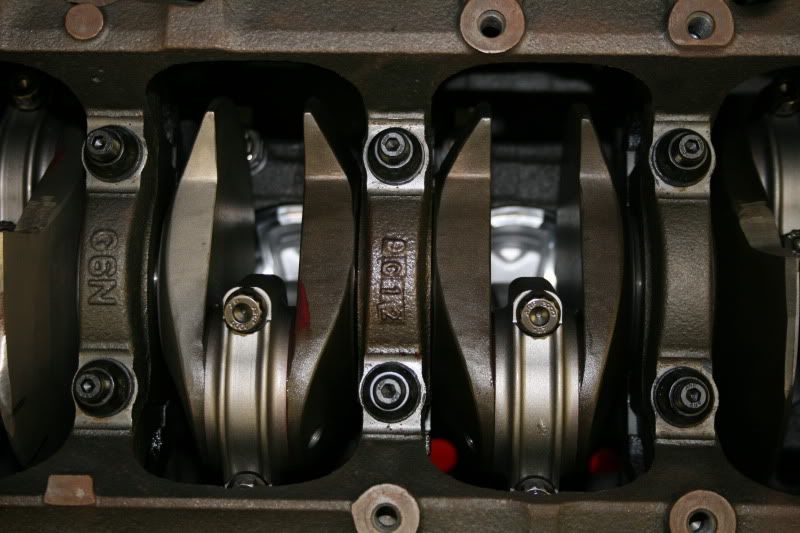

ARP main studs and ACL bearings... we know what they look like
These to go on:
And that's about where we are with it.
Mat's waiting to swap out the ARP 2000 rod bolts for the ARP custom age 625's

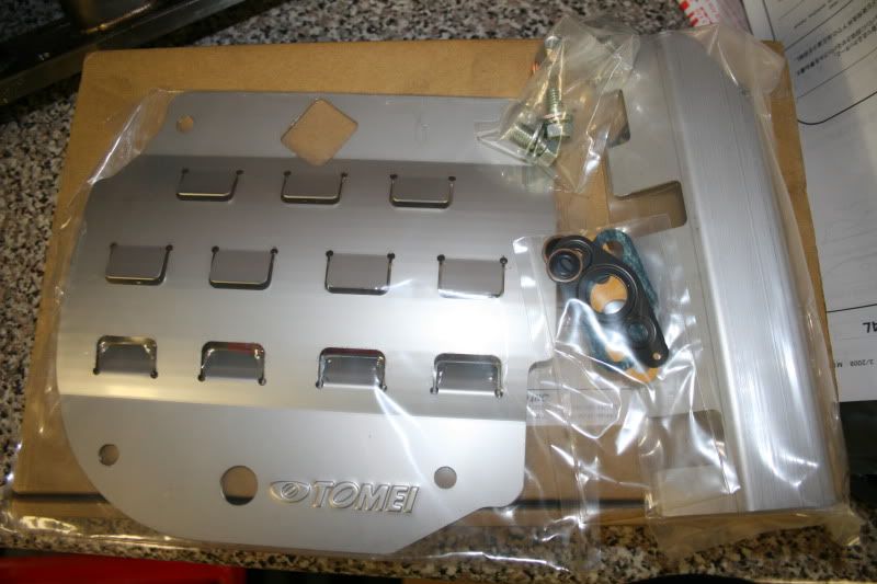

These bits to go on to finish the short block:
Balance shaft eliminator kit
Full OEM
gasket kit
New OEM
water pump
New OEM
oil pump
New OEM
sump kit
Bobs your mothers, brother.... short block done.

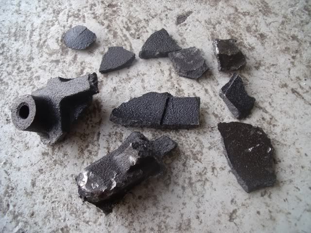

The damage:

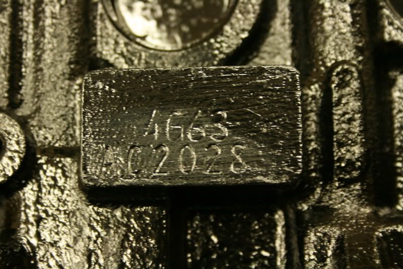

First on the shopping list was a donor block. I managed to source a suitable block out of an Evo VI
These to go on:
Full OEM
gasket kitNew OEM
water pumpNew OEM
oil pumpNew OEM
sump kitBobs your mothers, brother.... short block done.

Umm not sure on the one - I can ask the question to Ross Sport. I will be interesting to see the weight difference over the OEM crank.

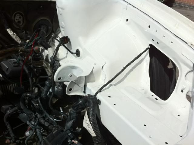

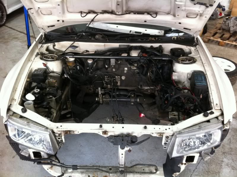

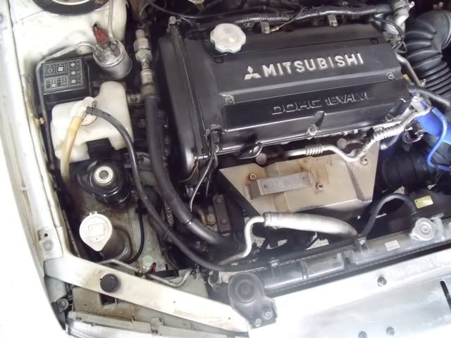

Engine bay freshen up.

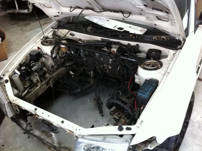

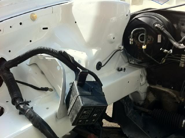

A few weeks ago I popped down to MG Autos to see how things were.
I had a chat with Mat and asked him what could be done about engine bay as it was looking a bit sorry for itself (which no suprise as the old girl is 13+ years old now).
Some old pics how the engine bay looked before:

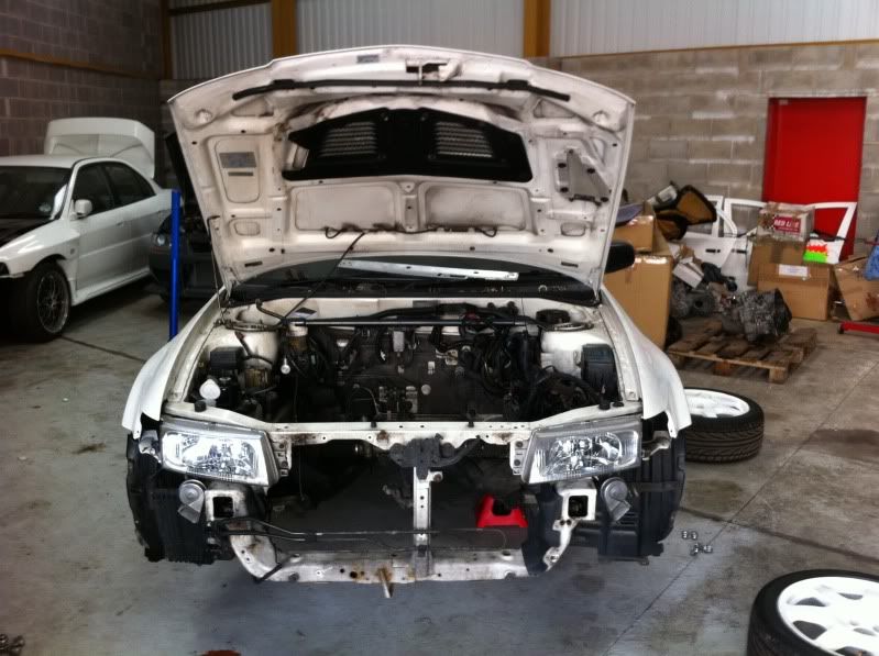

It would be a bit unjust to put a brand spanking built lump into a scruffy bay.

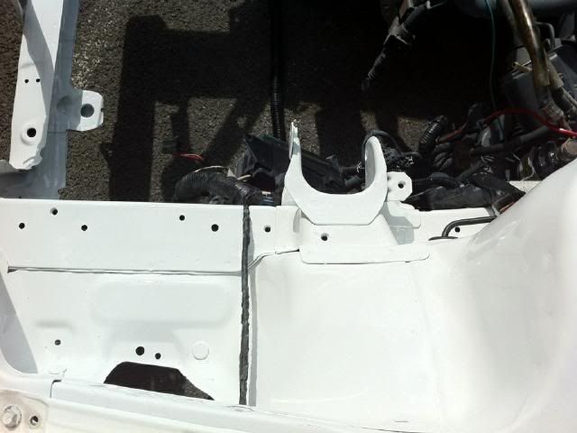

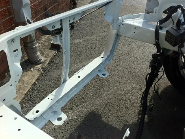

So a bit of a steam clean, prep and some fresh paint:
Some pics Mat txt me today after some MG'lovin:
Those with sharp eyes will have noticed the battery/earth bracket points have been removed as the battery is going to be relocated in the boot - much smoother now
Next on the list is a loom trim.....
and then the engine is going in!!!!!

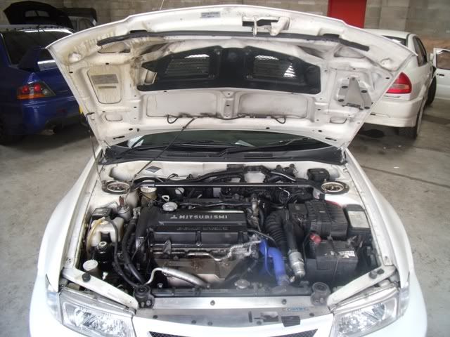

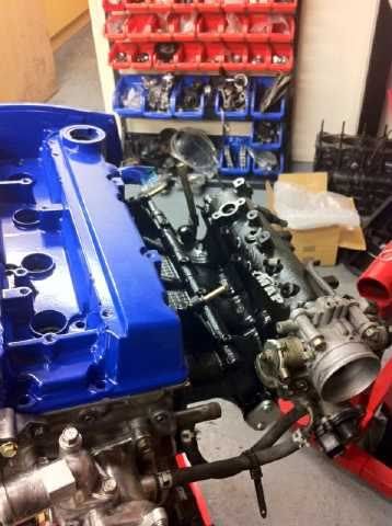

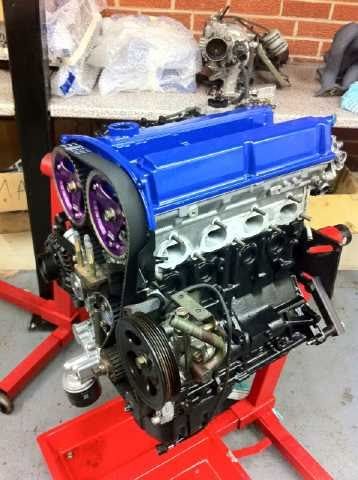

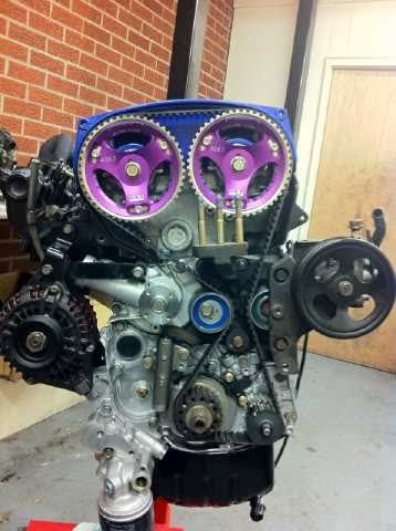

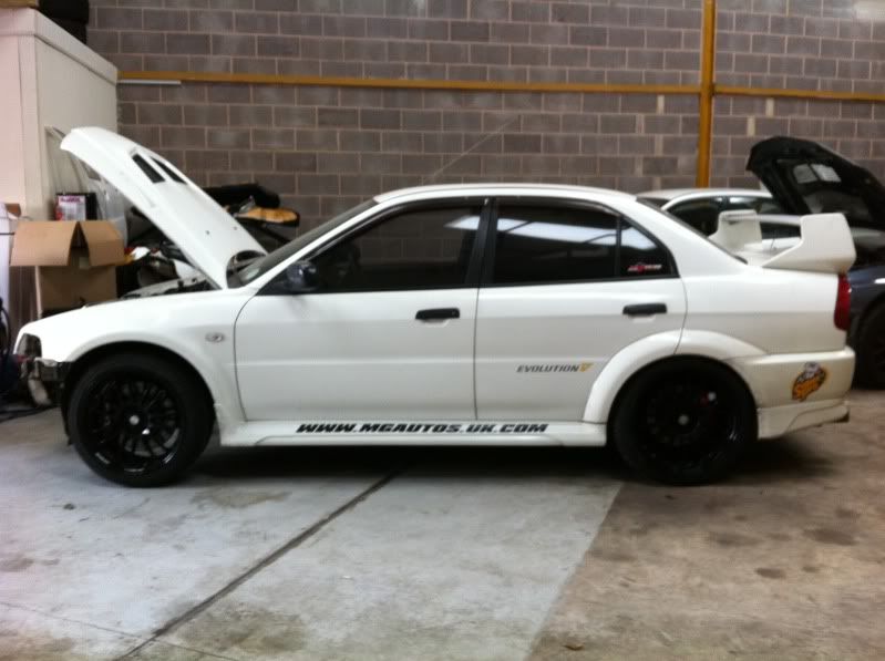

Update on the motor :)
Mat txt me a few pics of how things are progressing
(apologies for the low res MMS shots)

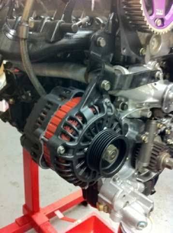

The motor:

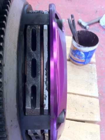

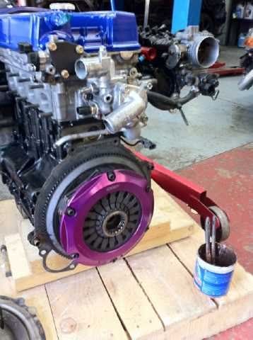

Exedy twin - refurbished with new plates

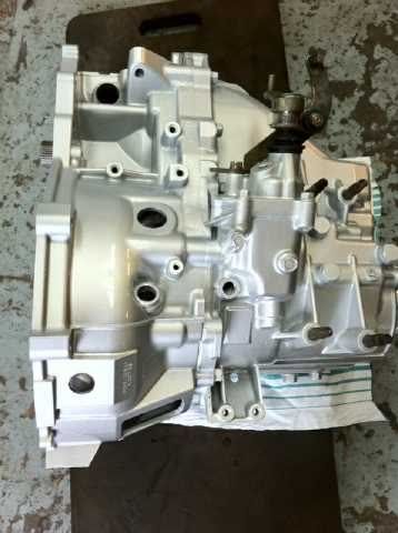

Gearbox - refurbished and tinkered to MG "sprint spec"
That's all I've got for now - will update soon

The motor:
