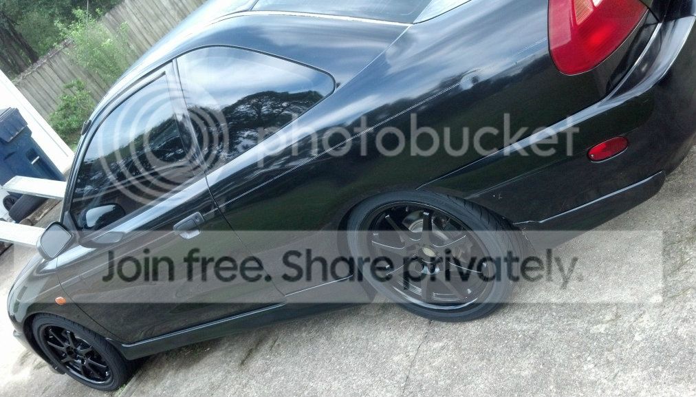

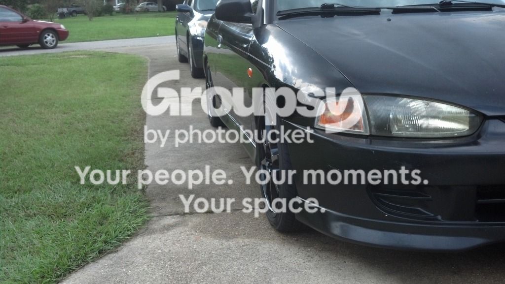

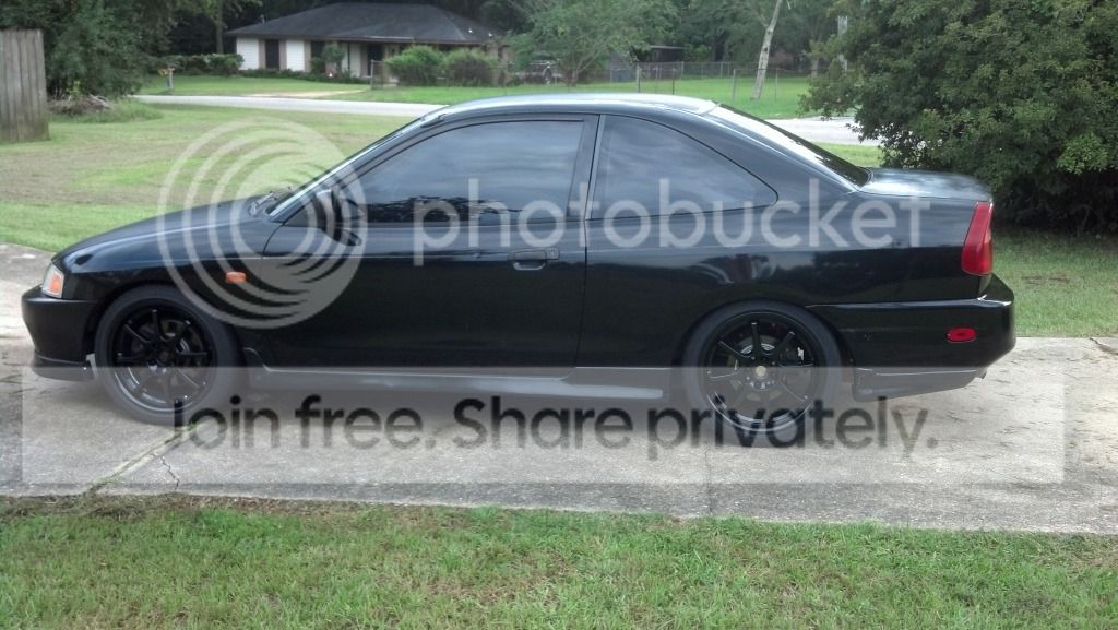

Old Aug 21, 2012 | 06:36 PM
  #40
armeddoc's Avatar
Joined: Dec 2011
Posts: 63
From: South Alabama
The Mirage as it sits today. :Mitsubishi3:
Needs a paint job, but that's about it for the outside. Just a few more little things...

Very nice!!
