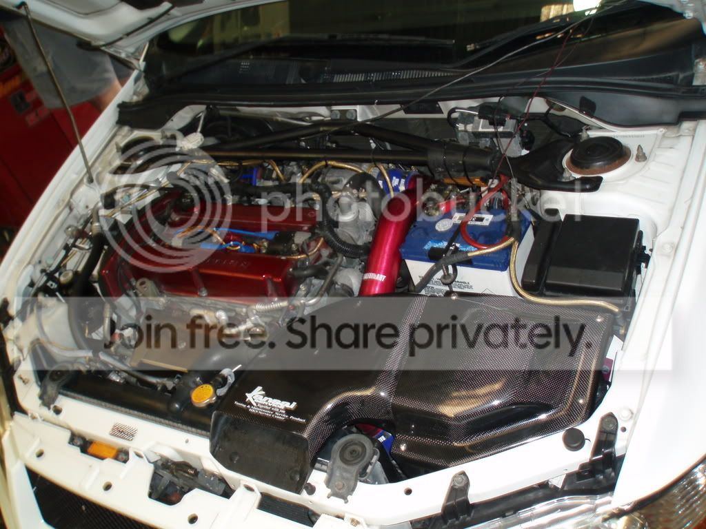

It was a little rough around the edges, had had a quick and rough rebuild a few weeks prior to my ownership by the previous owner as it had broke the ring lands off of several pistons due to a crazy aggressive tune in Japan which wasn't really going to work on anything less than Ethanol or C16 out here.
Mods at the start were cat-back, HKS intake and grenade tune.
Added a front pipe, 4-bar map sensor, MR Bov, 3-port and retune. Quickly learning I had run out of fuel on the stock pump.
Replaced the pump and cleaned up the tune.

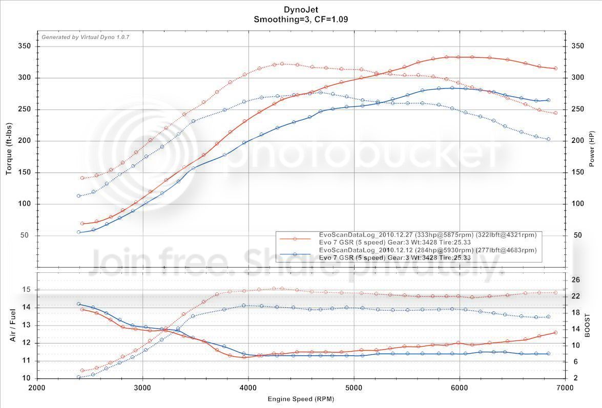

By this time E-Flex was rolled out in Newcastle early 2011, so injectors and a retune on the love juice were in order.
After retuning for a while and learning lots about ethanol in the same process this is where it was left for a while again to enjoy.

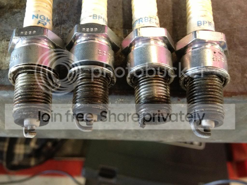

Jumped out and no oil underneath thankfully, oil all over the rocker cover having blown out from under the oil cap!
Pulled the plugs and found the culprit, other three were perfect, one was hammered.
Initially thought I had a injector fail on me as the damage was pretty catastrophic on cylinder 3, after speaking to a few more experienced Evo guys, they had all done the same thing themselves but on 98 you get a bit more warning of running out of fuel.
Major fuel surge causing the pump to suck air and leading to minor lean-outs on that cylinder as it fills with air the most on a stock intake, 1-2 laps worth at 25-26psi was obviously too much in the end.
Pretty upset with myself after working out the issue a week later, but kind of ironic as I had a block at the machine shop getting made up as a spare a few weeks prior.
Lesson of the day kiddies is to be careful, especially on E as the warning signs aren't purely obviously like 92 which will buck and kick when lean.
E will pull hard well into the high 13's, on a track where you aren't as alert to the motor and have a helmet on, its easy to miss the 'flat feeling' that a major lean-out on Ethanol gives.

Found the limit of the setup on 92 last night, unsure whether its just the Jasma cat-back with neck downs in the muffler raising its head or whether its the limit of the setup.
It'll run through first and second gear at 28psi no dramas, top of third it starts to rattle a touch and forget the rest at 27+.
This run wasn't clean but not far off it with the odd 1-2 counts of knock, I dialed it back a touch though to mid 420's to allow for weather changes.
