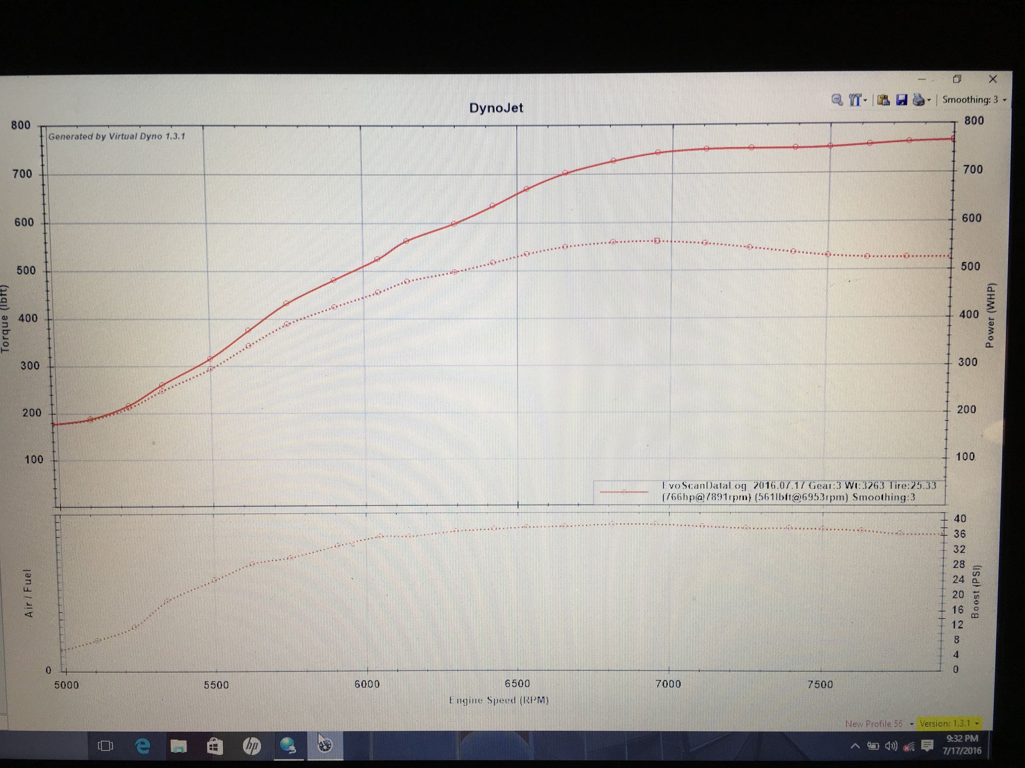

Afr needs tuning 4 sure. When I rescaled my load table I accidentally shifted my timing map and the added timing along with more boost gave me the 800hp. Looks like I had some wheel spin causing the graph to look funky, but I'm pretty sure it's at 800 or close. Thanks Superstock

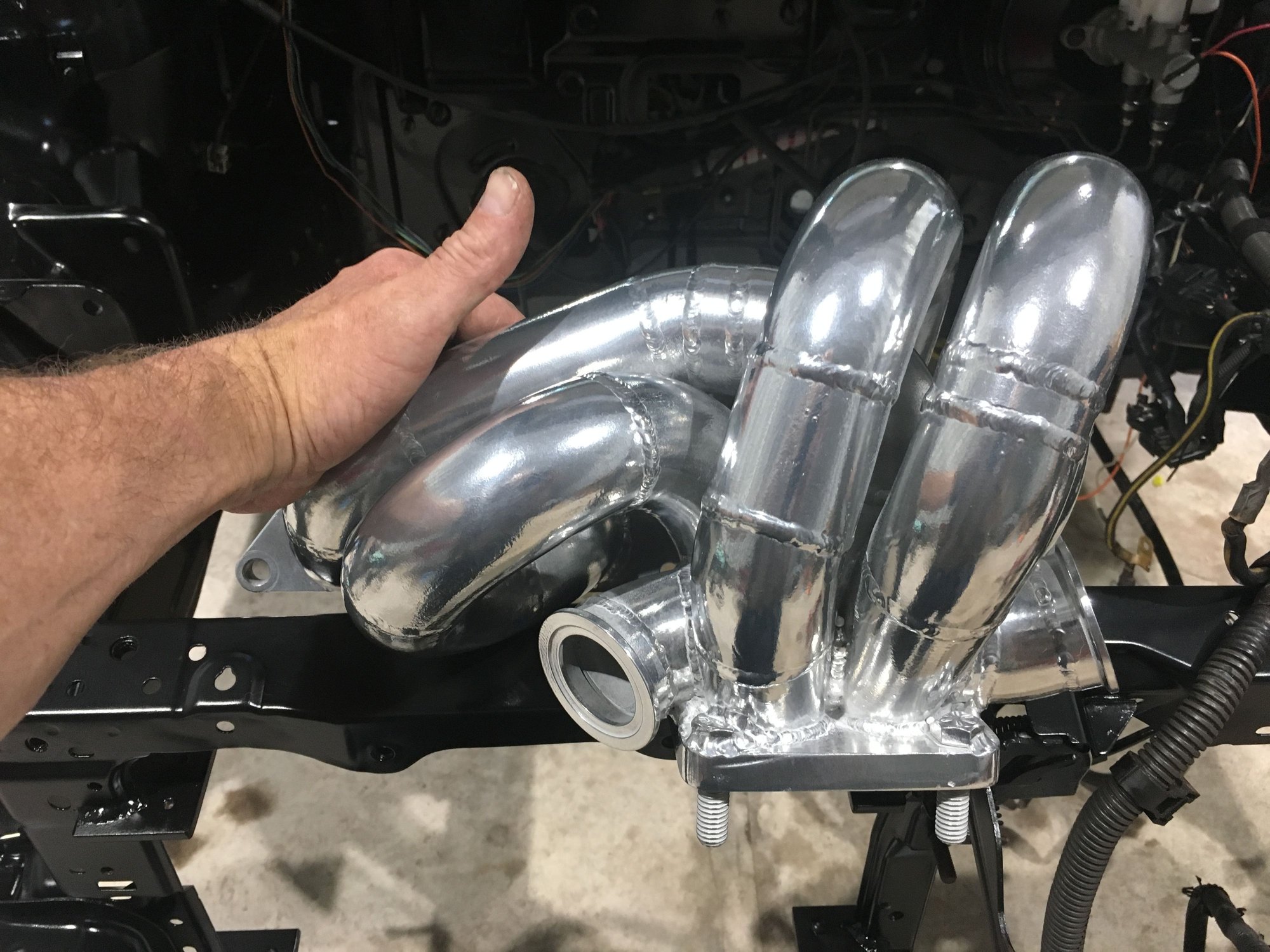

Manifold is back for jet hot.

That is an awesome curve. Power all the way to 8k!
