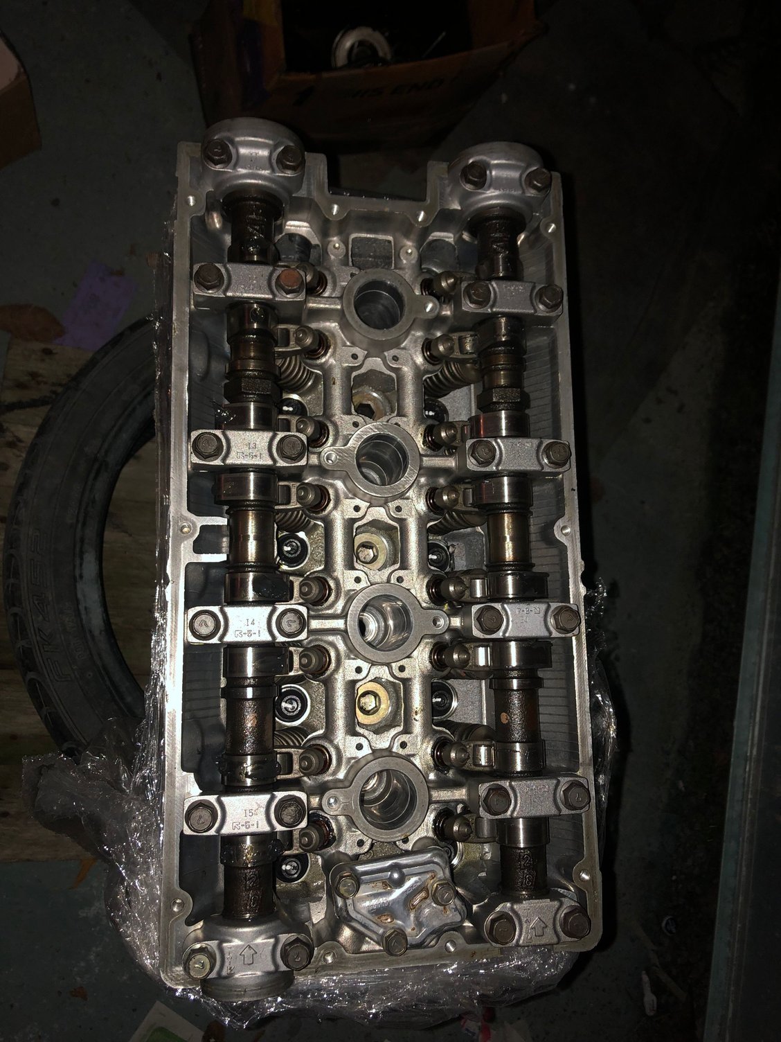

Bit of a update,
just had my adjustable cam gears and arp cam gear bolts turn up so I can finally time up my engine

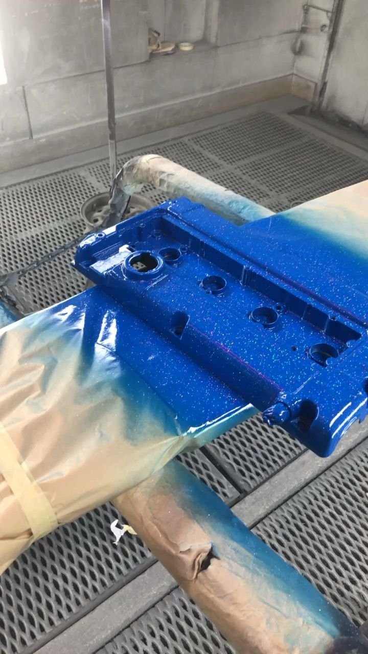

Another update hope it’s works this time and it didn’t the other night .
I just got my car back from storage so I’ve been getting stuck into it. Had to torque my cams down and bit the cam seal , colour coded my rocker cover and waste gate, had to replace one of the new cam seals because the sprint cam out of it and didn’t realise till after I installed the seal , lucky I have friends at the local Mitsubishi dealer
Blacked out bonnet vents
Rocker cover and waste gate

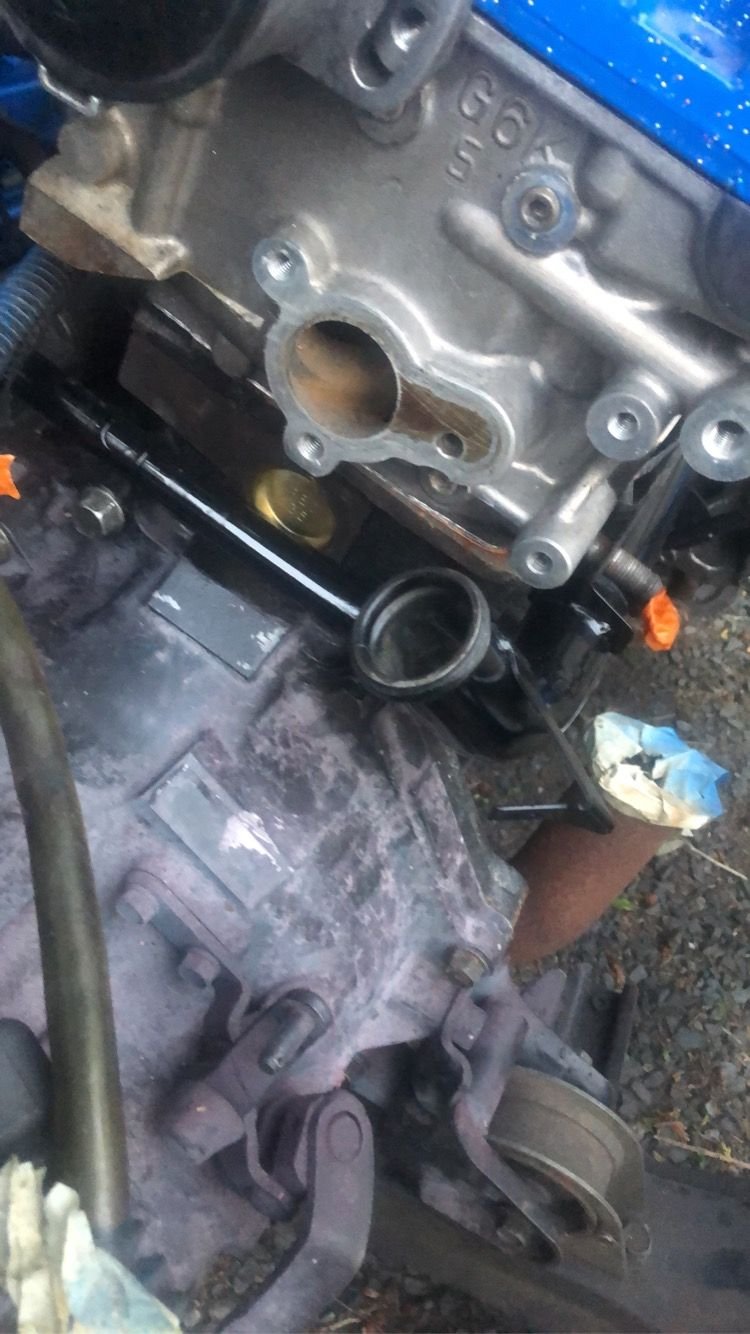

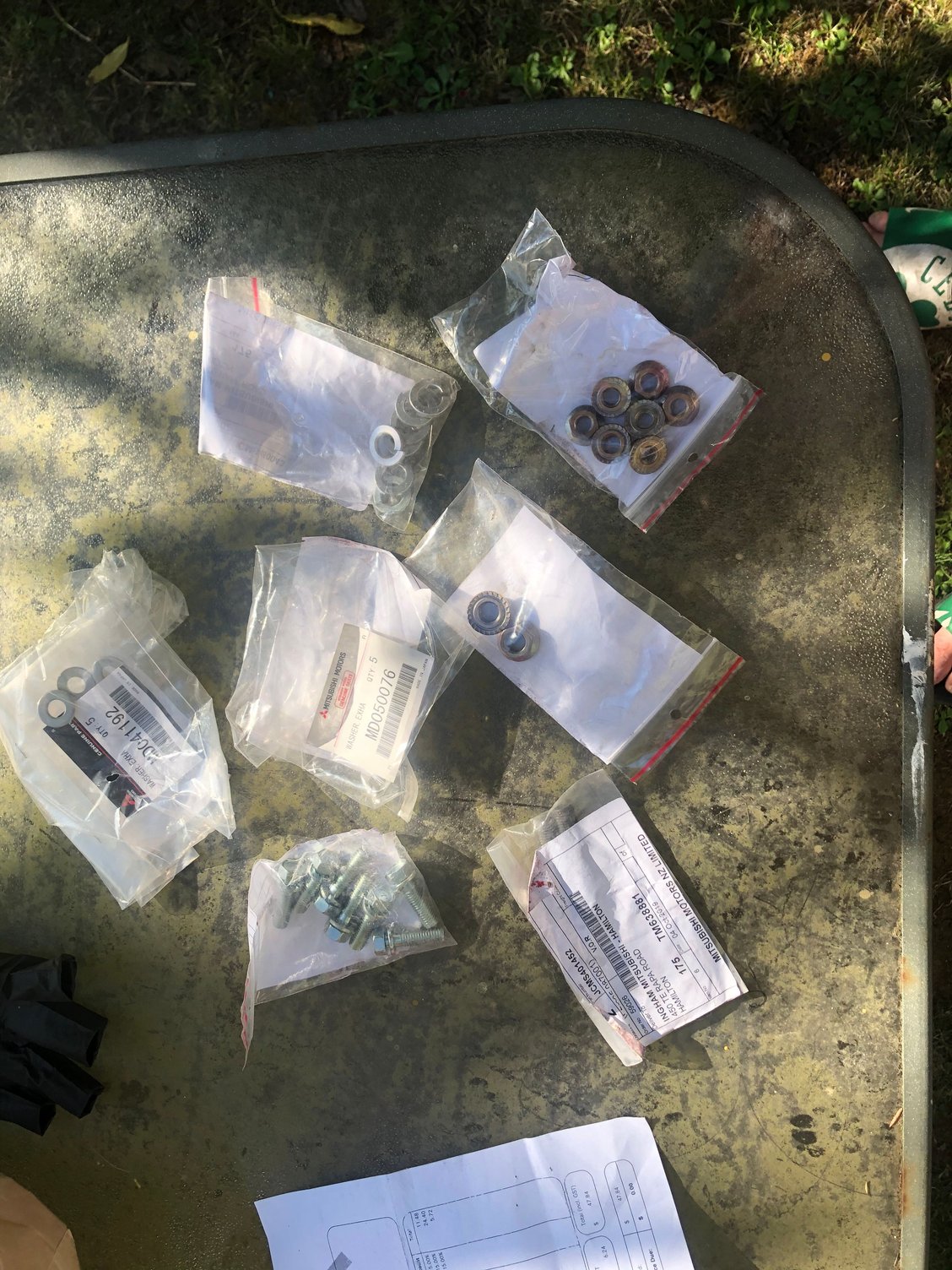

Got the water pump on now after my genuine bolts turned up from japan, also got my gas tank seal done
Found out I had a walbro pump
Water pump bolts from Mitsubishi

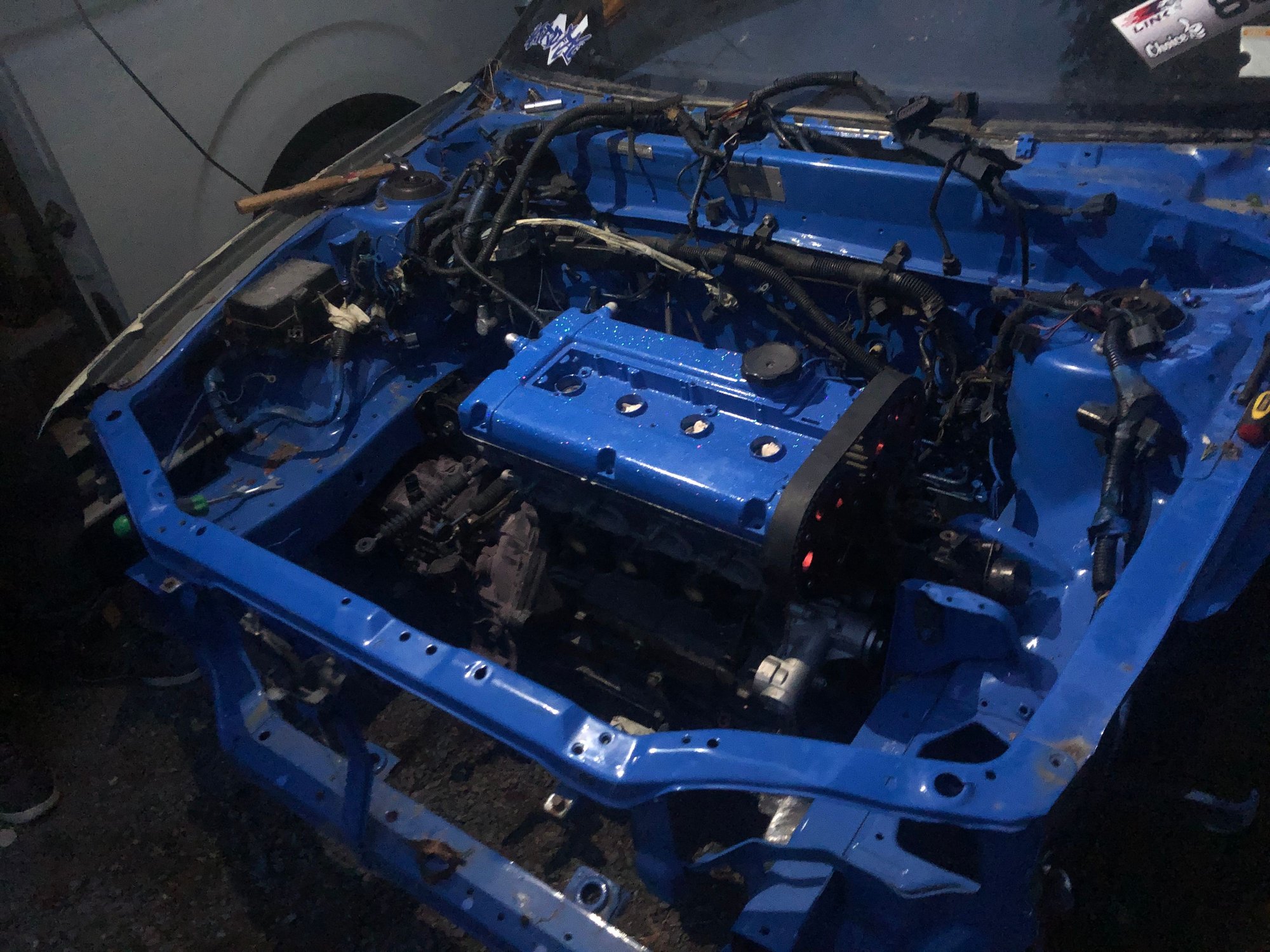

Bit of a update just got all new intake and exhaust manifold studs , finally gotta new clutch setup , finally got the engine in , Now I got a month off for isolation since New Zealand is in full lockdown at the moment.

Covid-19s been good to my car as I’ve had time to work on it.
all though not to much has happened, I’ve just fitted up the water pipe that goes around the block on and got my wastegate back together and I fitted up the exhaust manifold and turbo up to the engine. Now the task of trying to get my compressor housing to sit where I want it to for the intercooler piping
