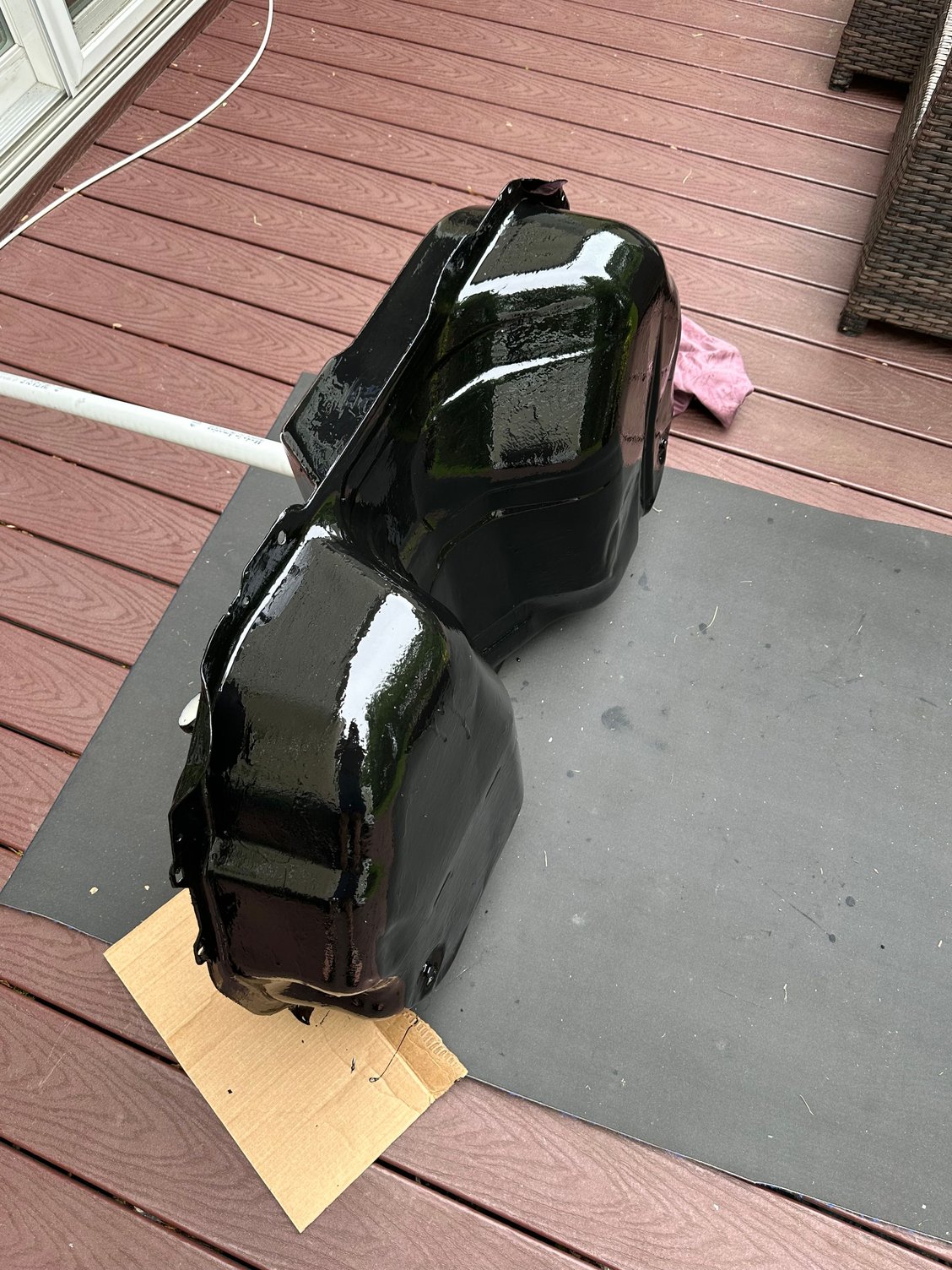

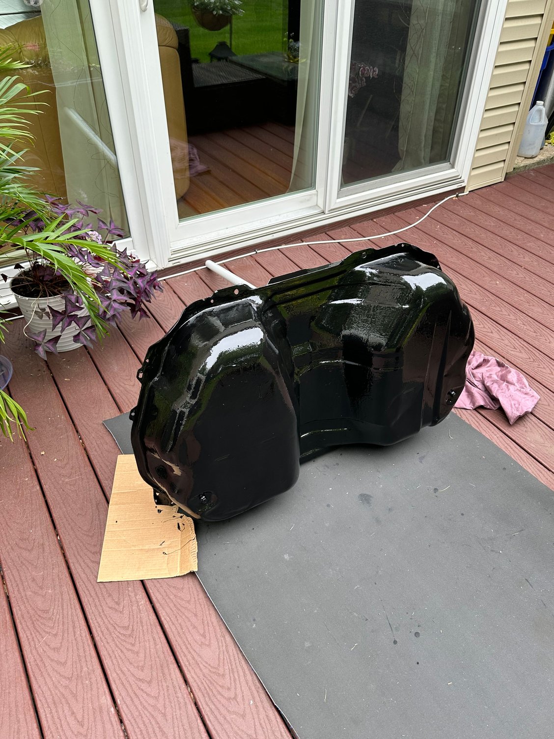

Jut got my gas tank and steering rack painted. 3 Coats of Master Coat Primer (bridge primer 150,000 in salt water test compare to Por-15 15000 hrs) (3) coats AG11 black (subway paint)

Smart work with that gas tank!

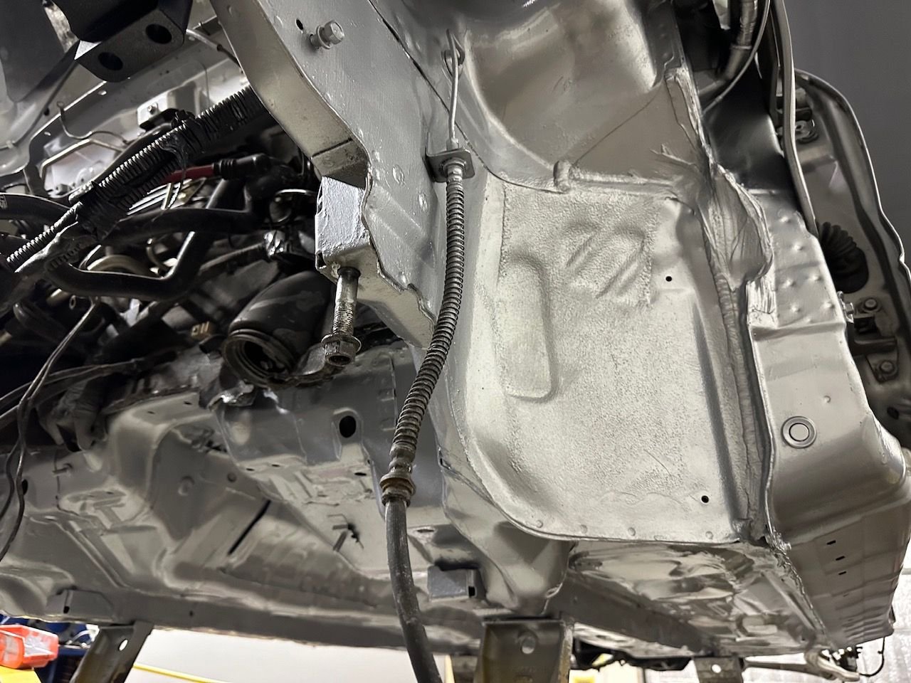

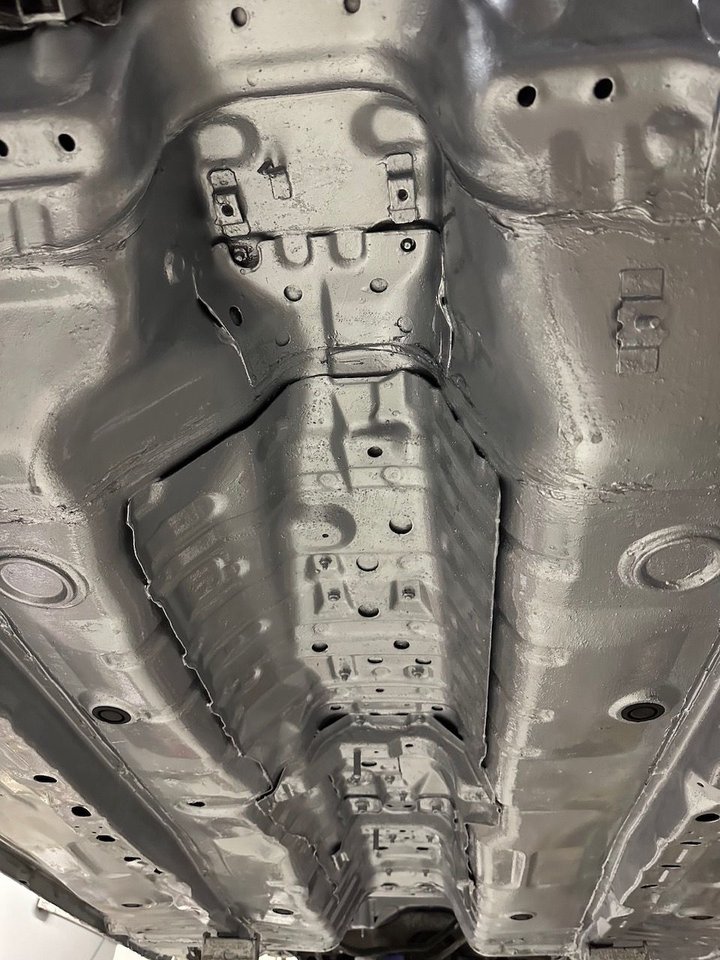

Used Master Coating Silver primer mixed which is mixed in with aluminum and their subway paint. If anyone is curious, this is industrial stuff, I would recommend to anyone who wants durable things.
Old May 5, 2026 | 06:44 AM
Evo8_UA's Avatar
Joined: Mar 2022
Posts: 50
Likes: 13
From: Lincoln Park NJ
painted those as well =)

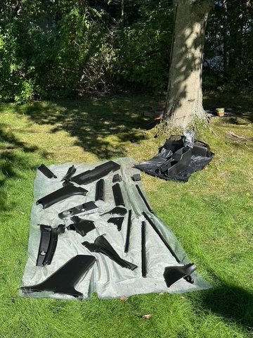

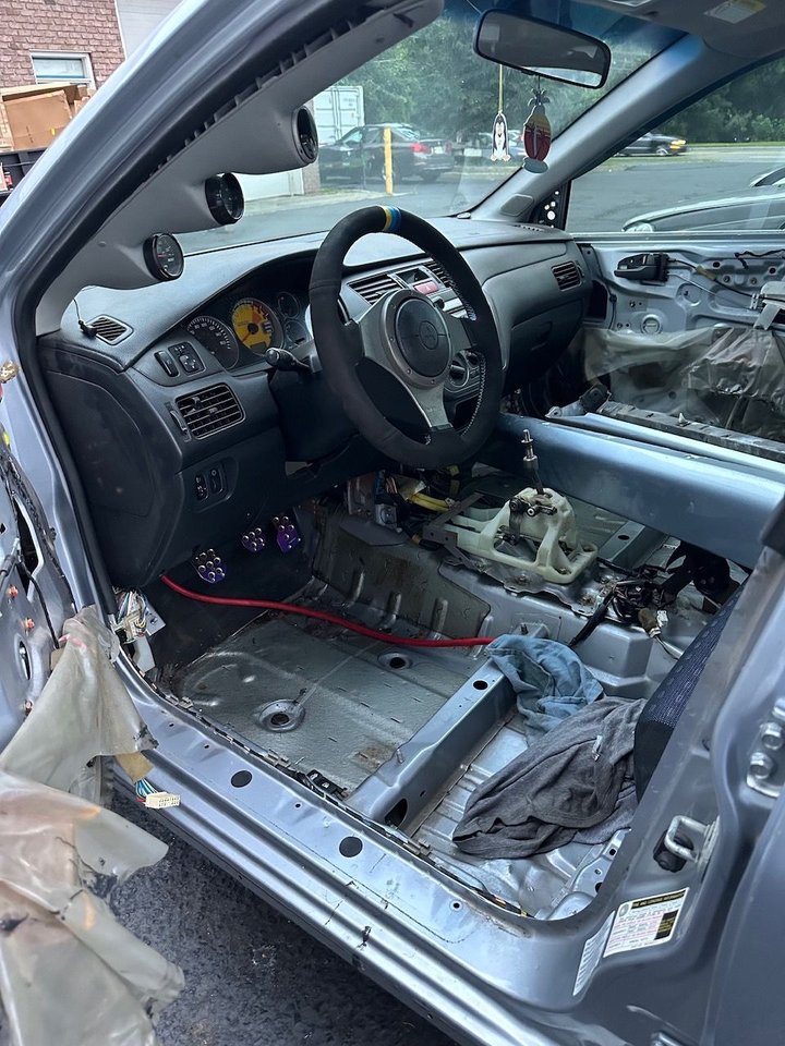

Gutted all interior and repainted all interior pieces. Re-done steering wheel and replaced cluster, those will go for sale. Painted interior floor and washed steamed interior carpet

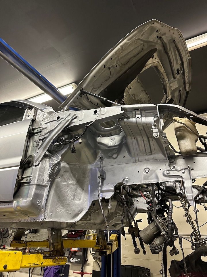

Old May 5, 2026 | 06:55 AM
Evo8_UA's Avatar
Joined: Mar 2022
Posts: 50
Likes: 13
This is how she looks underneath.

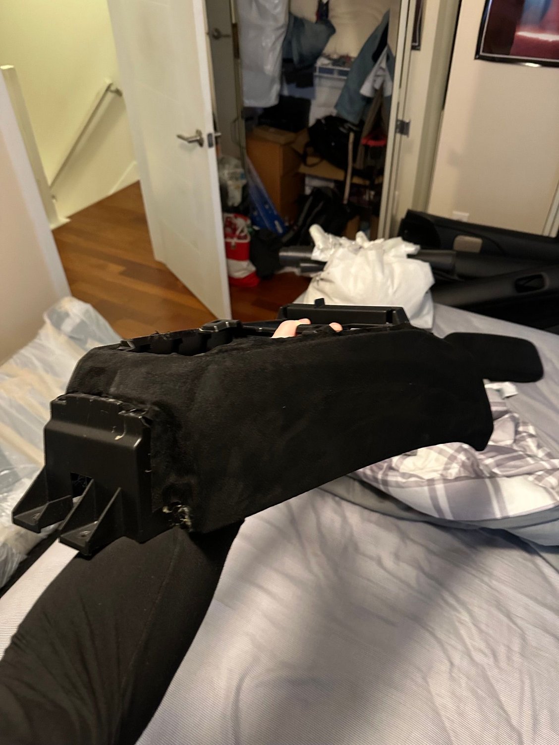

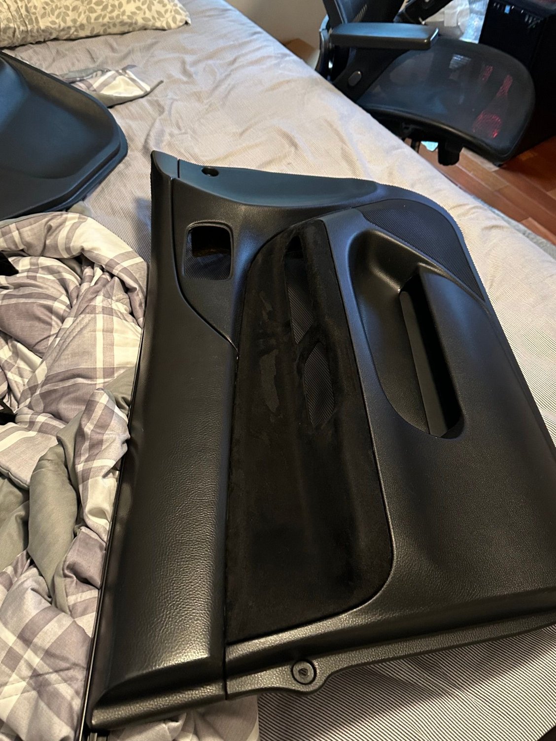

Got some free time on my hands last weekend did the door cards with suede. I suppose I get carried away at times...
Old May 5, 2026 | 07:53 AM
thepoint4life23's Avatar
Joined: Jan 2009
Posts: 1,563
Likes: 43
From: Columbus, Ohio
How hard was it to do the door cards. I need to do something like that. Looks great.
Old May 5, 2026 | 08:14 AM
Evo8_UA's Avatar
Joined: Mar 2022
Posts: 50
Likes: 13
Honestly pretty painful. You have to get suede that stretches really well. Hard to get it to stick, so you have to spray glue as go even then after it tries to come off when fully glued, mainly on sides walls atop from where plastic trim gets inserted. I wasted so much much material on this. If I were to start over this process probably would buy ready to glue ones off ebay search key words uk company on ebay >(Mitsubishi Evo 7 8 9 JF1 4X Door Card Trim Real Leather Covers RED STITCH | Multicolor | Shift Boot | Made in United Kingdom) or if you up to the challenge difficulty on scale probably 7/10, you really have to take your time.
