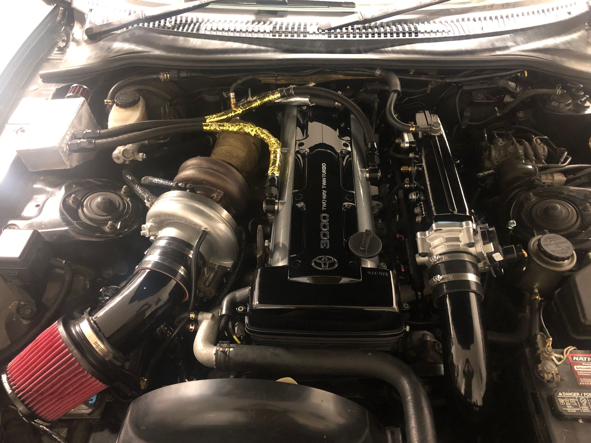

The Supra started out as a stock auto twin turbo car and turned into a pump gas 650whp 6spd the year after. It was a stock bottom end 2JZ GTE with T56 magnum from Grannas racing. I touched almost everything on car except for the intake manifold and bottom end.
It was a great car and fun to drive but with all the attention it got from people and police. It didn’t feel as enjoyable as it should have been. Being in Montreal, Canada there were only a handful of supras around so everyone made a big deal of it when it was driven.

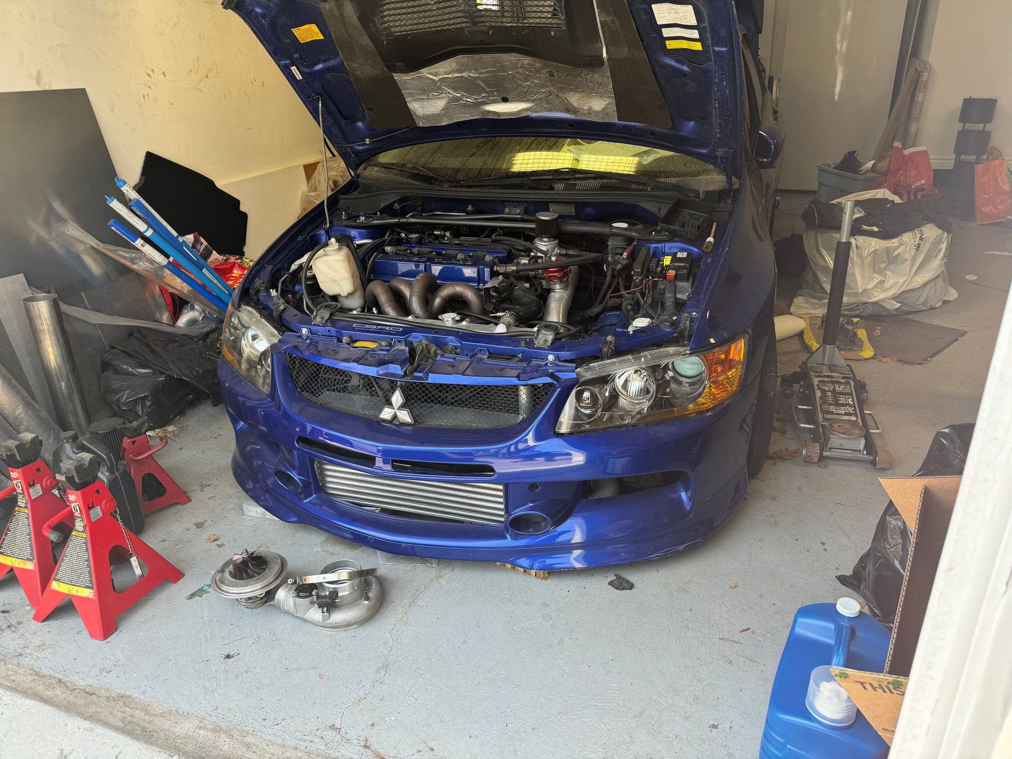

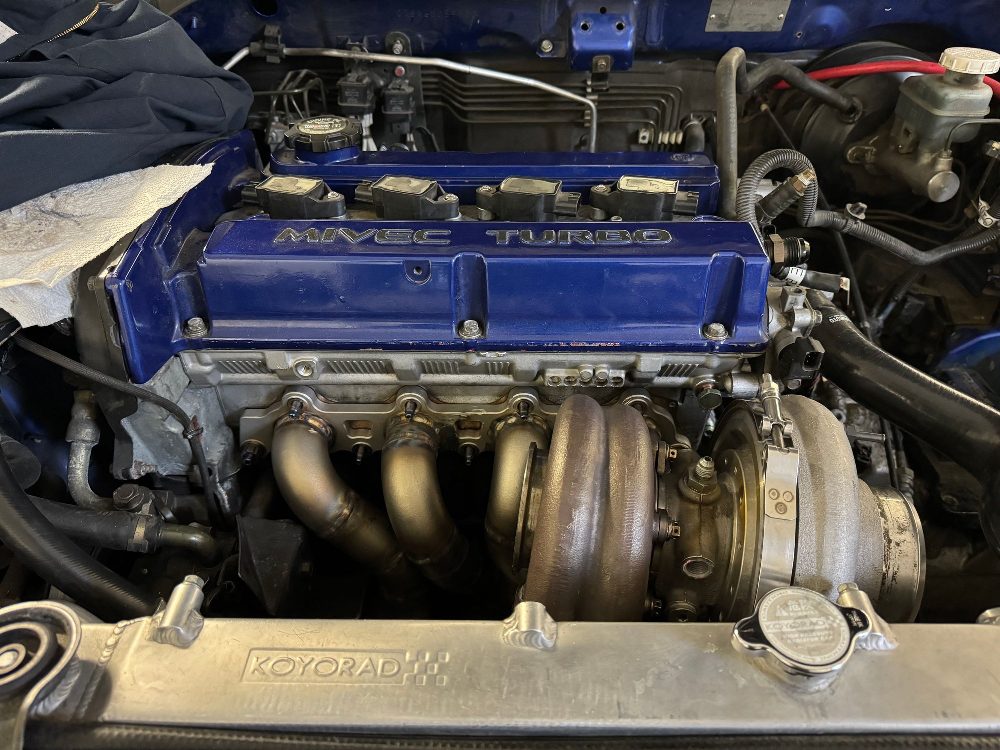

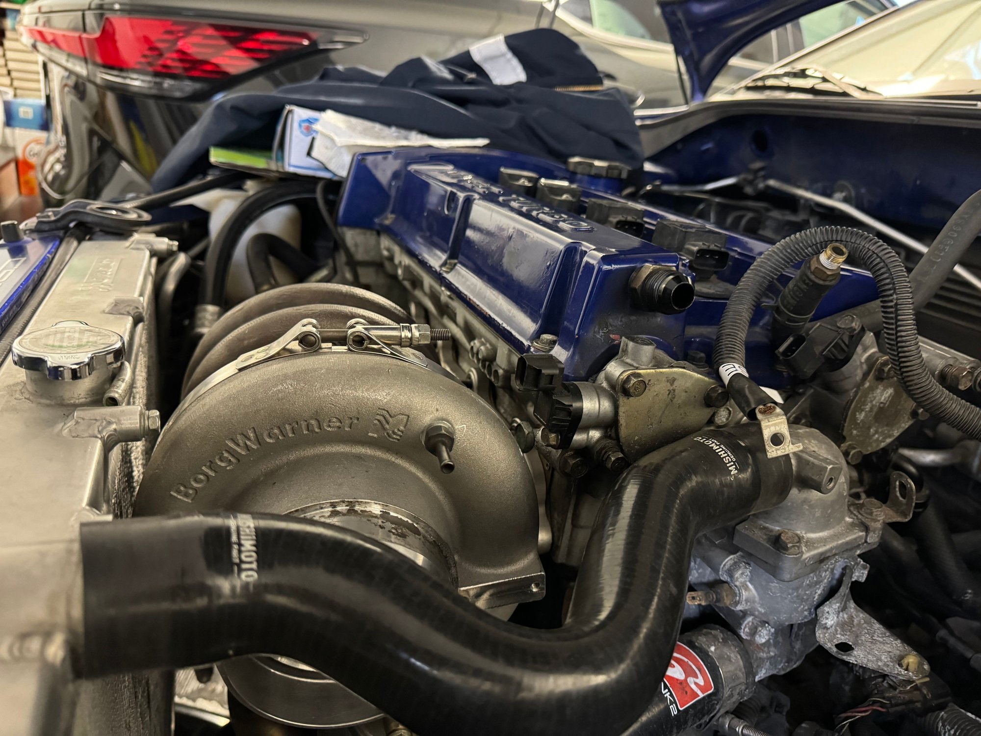

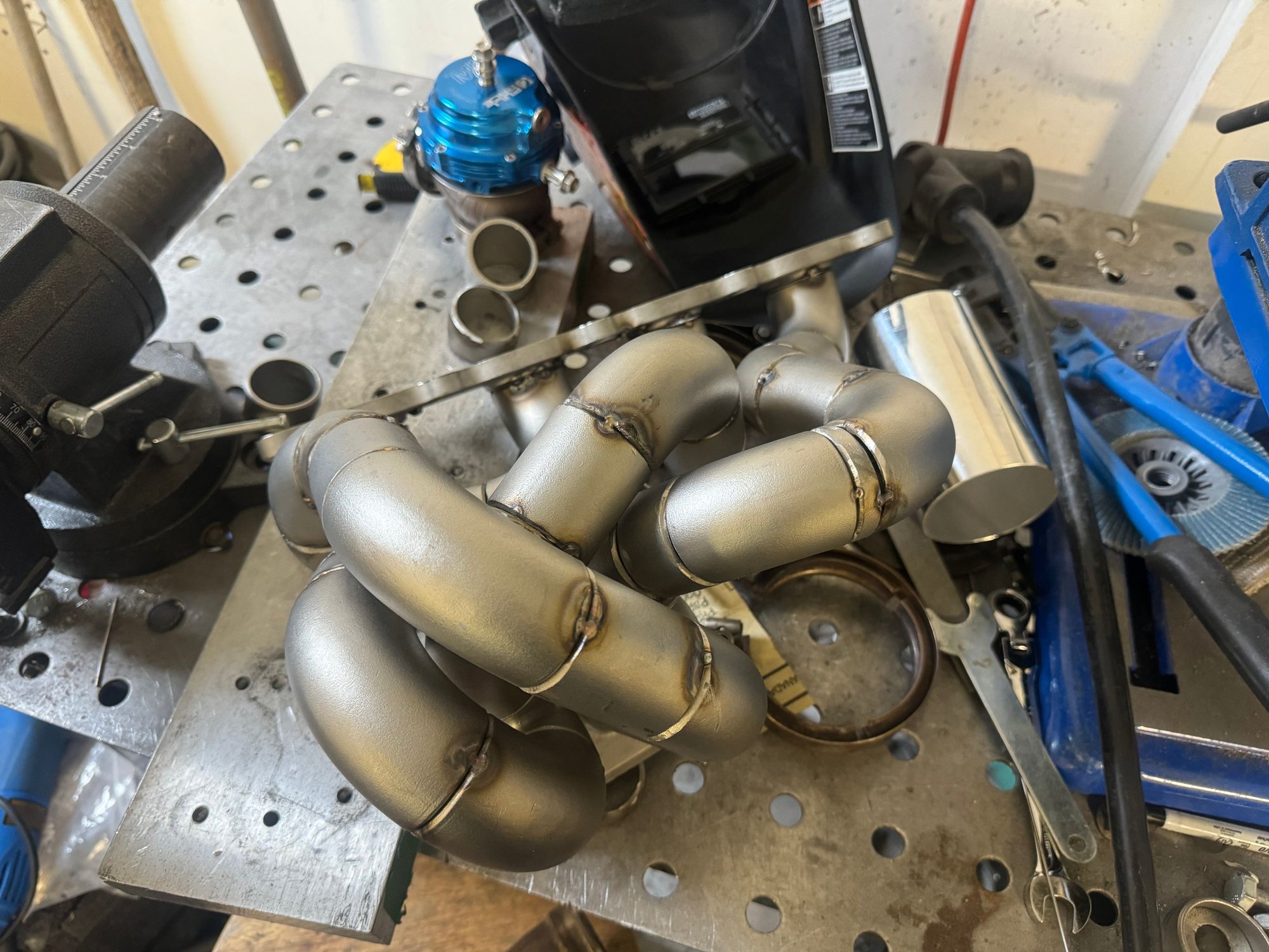

As I was removing the oem wiring harness I noticed that the current GT35 turbo was shot. Tons of in /out shaft play. with a leaking compressor seal. I had an EFR 9280 lying around in my house so I decided the evo would be the perfect candidate for this turbo.

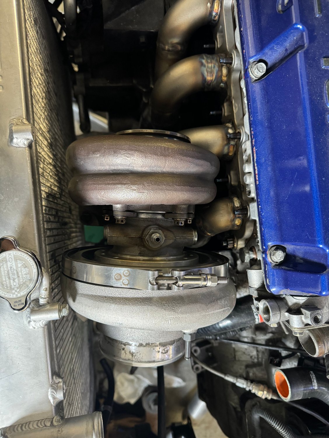

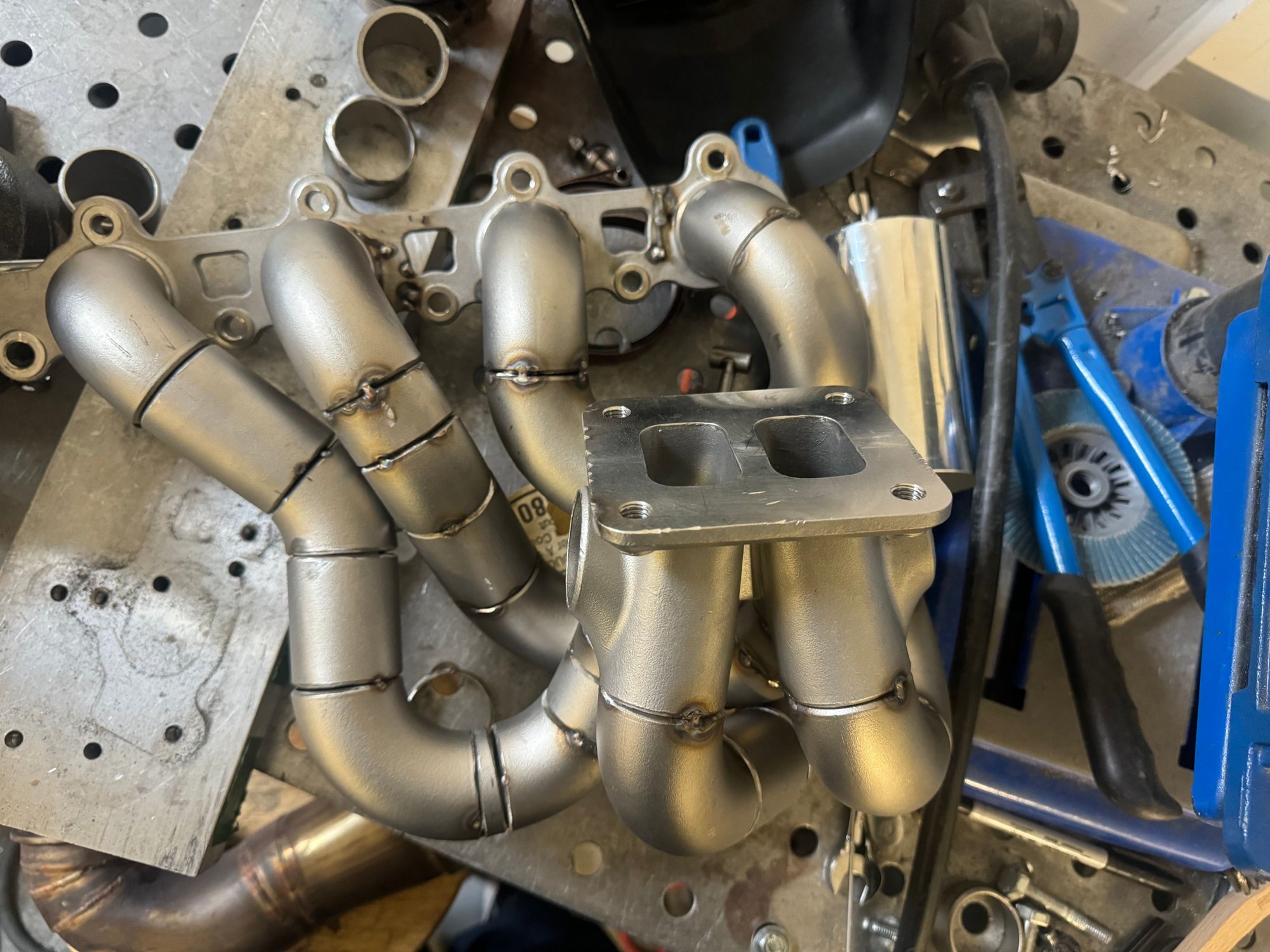

Since the GT35 had a v-band housing, I needed a new T4 divided manifold for the EFR. I wanted a top mount for the car but I couldn’t find anyone that made a divided T4 top mount for the Evo. I took it upon myself to make one.
Here’s what it looked like tacked up after test fitting.
All welded up and installed with turbo:

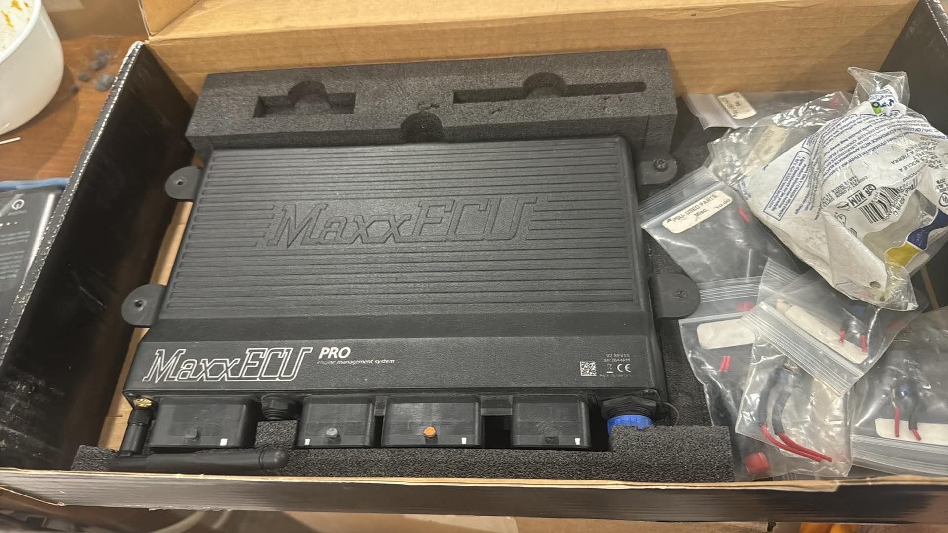

The initial plan was just to add a standalone but it has spiraled out of control after the broken turbo. I plan to modify the fuel system and potentially build the block later this year.
I am currently tackling the fuel system so I will try to give some updates later.

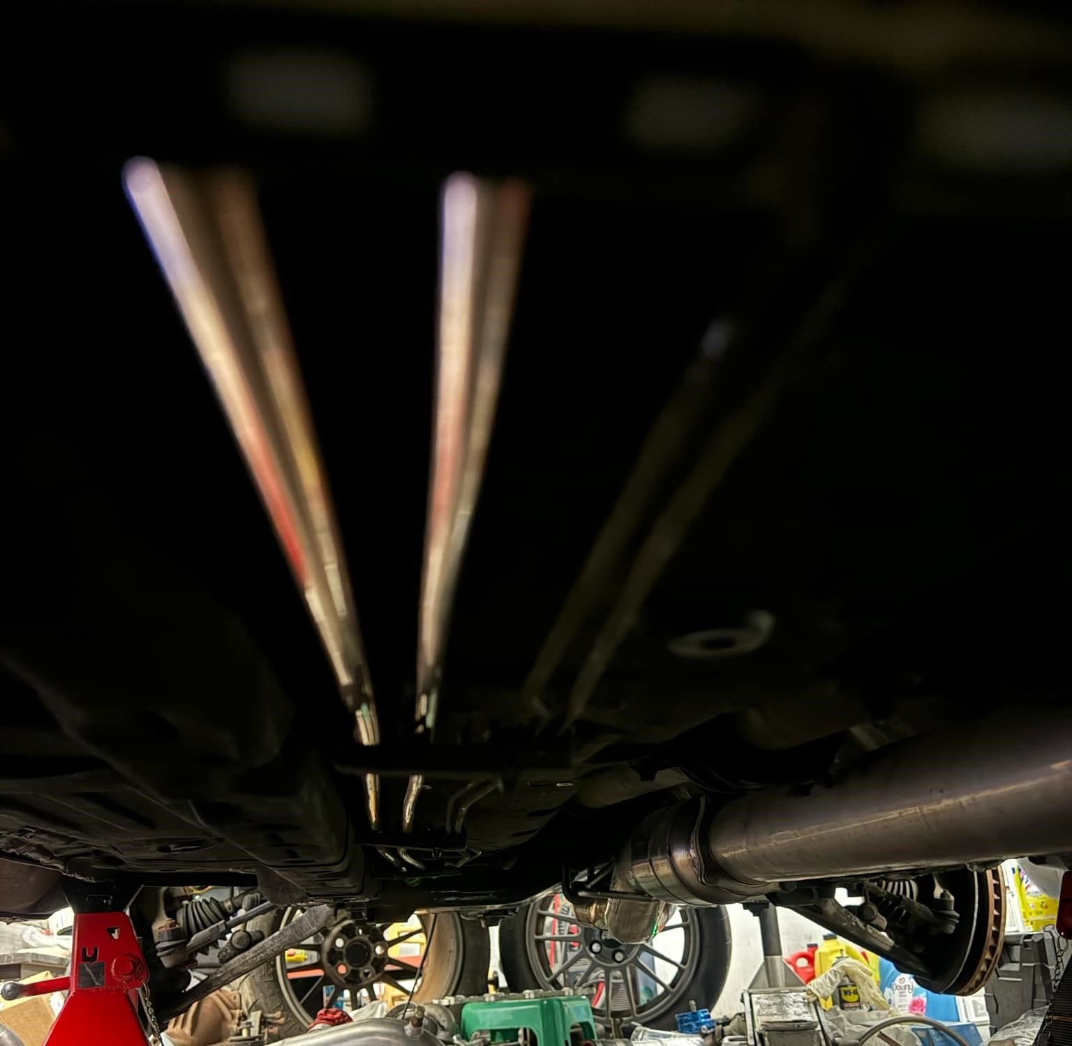

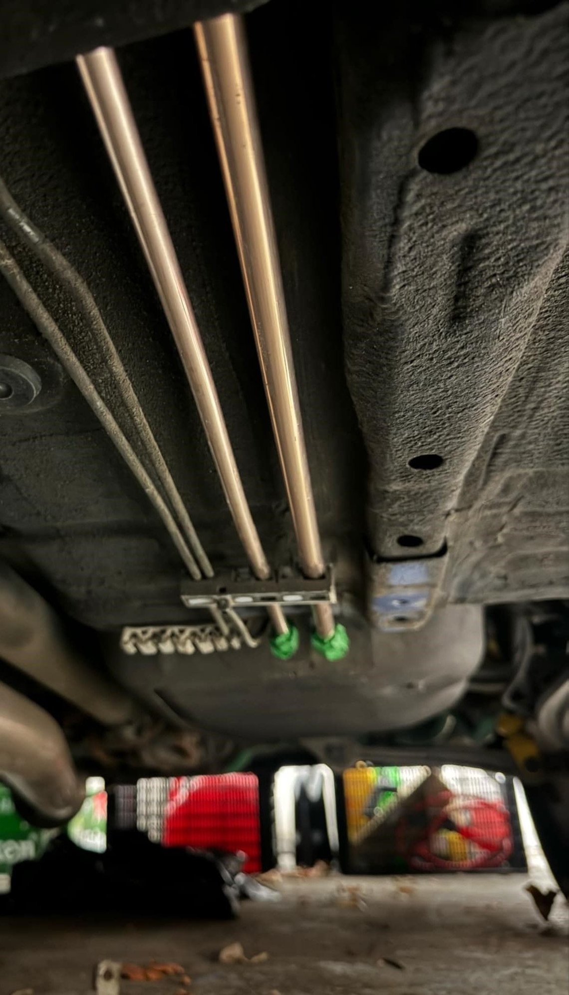

Yeah, -10 feed and -8 return was my initial plans but I wanted to use hardlines underneath the car instead of running PTFE lines the entire way and I couldn't find anyone that sold 5/8" stainless or copper nickel tubing. The largest I found at a reasonable price was 1/2" copper nickel tubing. I found some 5/8 tubing overseas but shipping costs were unreasonable. I used a fuel flow calculator and at my future power goals (900-950whp), there was only a 3-4 psi pressure drop between -8 and -10 feed lines. So I ended up running with some -8 and -6 copper nickel hardlines. As for the fuel filter, I will go with the ID F1250 since its marginally more expensive than the Fuelab 818 but flows way more.
Some pictures of the -8 and -6 lines routed under my car. I removed the OEM fuel lines and the evap line too so I could keep the oem brackets which I had to modify to fit the lines. I know that no one will look under the car at fuel lines but I never really liked how most cars just had braided hose ziptied to the oem hardlines. Next thing i'm going to do is run the PTFE hoses to the fuel rail and hanger.
